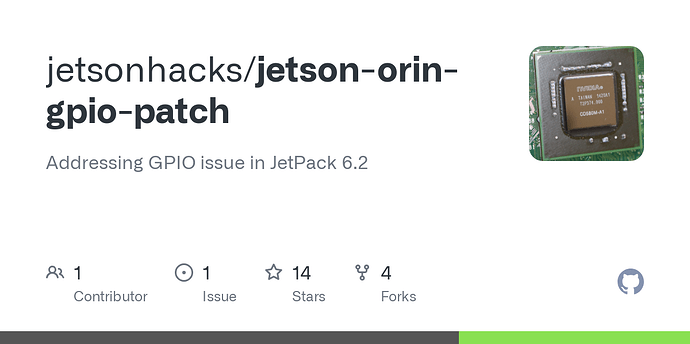

the youtube tutorial looks based-on JP-6.2/r36.4.3, could you please double check you’re using the same release version?
Thanks JerryChang for the replay, the version Im using is r36.4.4.
hello alexis23,
please use the same Jetpack relese version as github mentioned.
