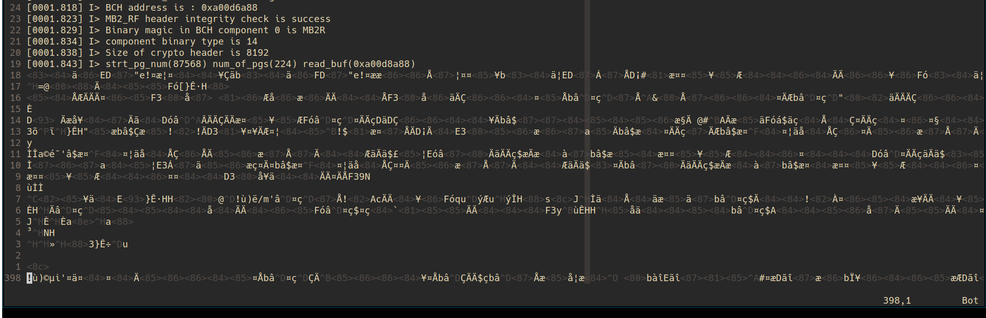

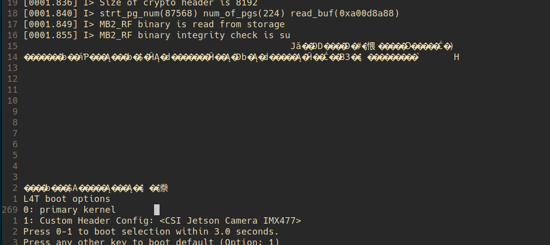

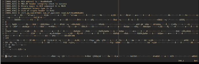

I have also found out that the Jetson AGX Orin does not print bootloader logs by default to UART. So I have enabled that. Here I have attached the bootloader logs without SSD and with SSD
jetson-agx-orin-log-without-ssd.txt (74.0 KB)
jetson-agx-orin-log-with-ssd.txt (28.3 KB)
I see only a bunch of garbled characters in the second log.
The garbled characters are coming on from line 18 like in the screenshot. After that, the device just restarts itself.
There are some garbled characters in some parts of the first log without ssd. But it does not causes the device to restart.
