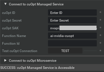

For cuOpt managed service, I am able to connect to managed service using SAK and function name as per below screenshot. I provided function name as ai-nvidia-cuopt which I retrieved from CuOptServiceClient.get_functions(). Hope that’s the right way.
When I tried to run cuOpt for solution. I got error asValueError: Unprocessable Entity - 422::
2025-06-12 10:10:54  [Error] [omni.ui.python] ValueError: Unprocessable Entity - 422:
2025-06-12 10:10:54  [Error] [omni.ui.python] At:
2025-06-12 10:10:54  [Error] [omni.ui.python]   d:/omniverse/apps/isaac-sim-standalonev420/extscache/omni.cuopt.service-1.0.0+106.0.0/omni/cuopt/service/cuopt_thin_client.py(563): _handle_request_exception
2025-06-12 10:10:54  [Error] [omni.ui.python]   d:/omniverse/apps/isaac-sim-standalonev420/extscache/omni.cuopt.service-1.0.0+106.0.0/omni/cuopt/service/cuopt_thin_client.py(667): _send_request
2025-06-12 10:10:54  [Error] [omni.ui.python]   d:/omniverse/apps/isaac-sim-standalonev420/extscache/omni.cuopt.service-1.0.0+106.0.0/omni/cuopt/service/cuopt_thin_client.py(791): get_optimized_routes
2025-06-12 10:10:54  [Error] [omni.ui.python]   d:/omniverse/apps/isaac-sim-standalonev420/extscache/omni.cuopt.examples-1.0.0+106.0.0/omni/cuopt/examples/costmat/extension.py(659): run_cuopt

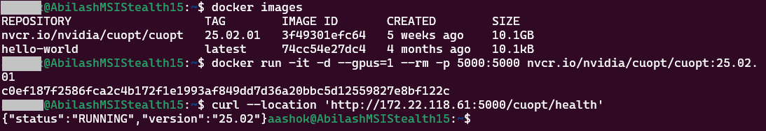

For cuOpt micro service, I am able to ensure micro-service is running.
When I tried to run cuOpt for solution. I got an error as KeyError: 'response':
2025-06-12 10:55:04  [Info] [omni.kit.app._impl] [py stdout]: Running cuOpt
2025-06-12 10:55:04  [Info] [omni.kit.app._impl]  - OPTIMIZATION DATA AT http://172.22.118.61:8000/cuopt/ HAS BEEN CLEARED -
2025-06-12 10:55:04  [Info] [omni.kit.app._impl] [py stdout]: SOLVER RESPONSE: {'detail': 'Not Found'}
2025-06-12 10:55:04  [Error] [omni.ui.python] KeyError: 'response'
2025-06-12 10:55:04  [Error] [omni.ui.python] At:
2025-06-12 10:55:04  [Error] [omni.ui.python]   d:/omniverse/apps/isaac-sim-standalonev420/extscache/omni.cuopt.service-1.0.0+106.0.0/omni/cuopt/service/cuopt_microservice_manager.py(23): get_routes
2025-06-12 10:55:04  [Error] [omni.ui.python]   d:/omniverse/apps/isaac-sim-standalonev420/extscache/omni.cuopt.examples-1.0.0+106.0.0/omni/cuopt/examples/costmat/extension.py(652): run_cuopt

@sophwats I tried with v25.02 using micro-services following documentation NVIDIA Self-Hosted Server Overview — NVIDIA cuOpt. However, I got the same error. Below listed are the reference screenshots.
We’ll reproduce this on our end, follow up with the Omniverse team and get back to you. Thank you for your patience.
