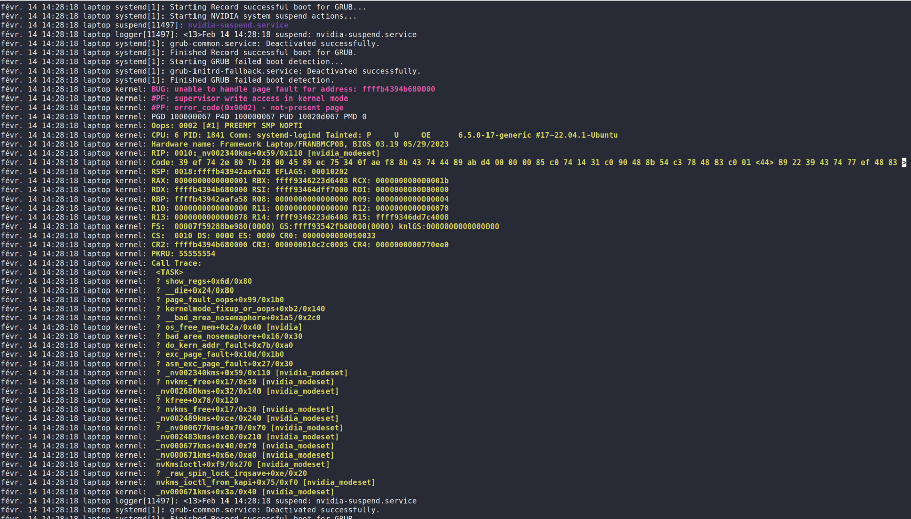

After what if I decide to suspend the computer I get stuck with this black screen :
And I have to force a reboot.
in journalctl output from the time I pressed the button to suspend :
I find this error :
You can download the complete journalctl output of the suspend sequence here :
journalctl.log (51.1 KB)

The nvidia driver doesn’t support hot(un)plug so before you turn off the enclosure, you will have to unload the driver, e.g. sudo modprobe -r nvidia

Depending on your modprobe config regarding nvidia,
  • try modprobe -r --ignore-remove nvidia-drm nvidia-modeset nvidia-uvm nvidia
  • make sure
sudo cat /sys/module/nvidia_drm/parameters/modeset
returns “N”, otherwise check your modprobe confing for the nvidia-drm modeset=1 option and set it to 0.

after changing modprobe config files you need to rebuild the initrd.
sudo update-initramfs -u
Also, if gnome-shell is running, you’re not running headless so this won’t work.
Thank you, so it’s not possible to hotplug a nvidia egpu on linux ?
Do you think I can try the “nouveau” drivers ?
or simply buy an AMD gpu instead ?
regardless, thank you for taking the time :)
There are two different mechanisms involved:
  1. AFAIK, Wayland /Xorg both don’t support gpu hot-unplug regardless of gpu vendor.
    So if you first turn on your egpu and then your computer, the display server will grab it and not let hold of it. Unless you configure Xorg/Wayland to ignore it. Xorg by creating a fitting xorg.conf, Wayland, I don’t know.
    If you first turn on your computer and only later the egpu, Xorg/Wayland will ignore it anyway, so there shouldn’t be an issue.
  2. before turning off the egpu, like said, the driver needs to be unloaded. For that, the option nvidia-drm.modeset needs to be 0 and nvidia-persistenced needs to be stopped.
    AMD was working on hot unplug support for the amdgpu driver but I don’t think this is actually implemeted in the mainline kernel.
Hello
Do you think this would be possible to achieve ? Even if I’m not running headless ?
Should be possible, for preliminary tests, make sure
returns N when the egpu is active. Then shutdown the computer, turn off egpu, turn on computer and only once you’re on the desktop, turn on egpu. Then check if you can unload the driver.
