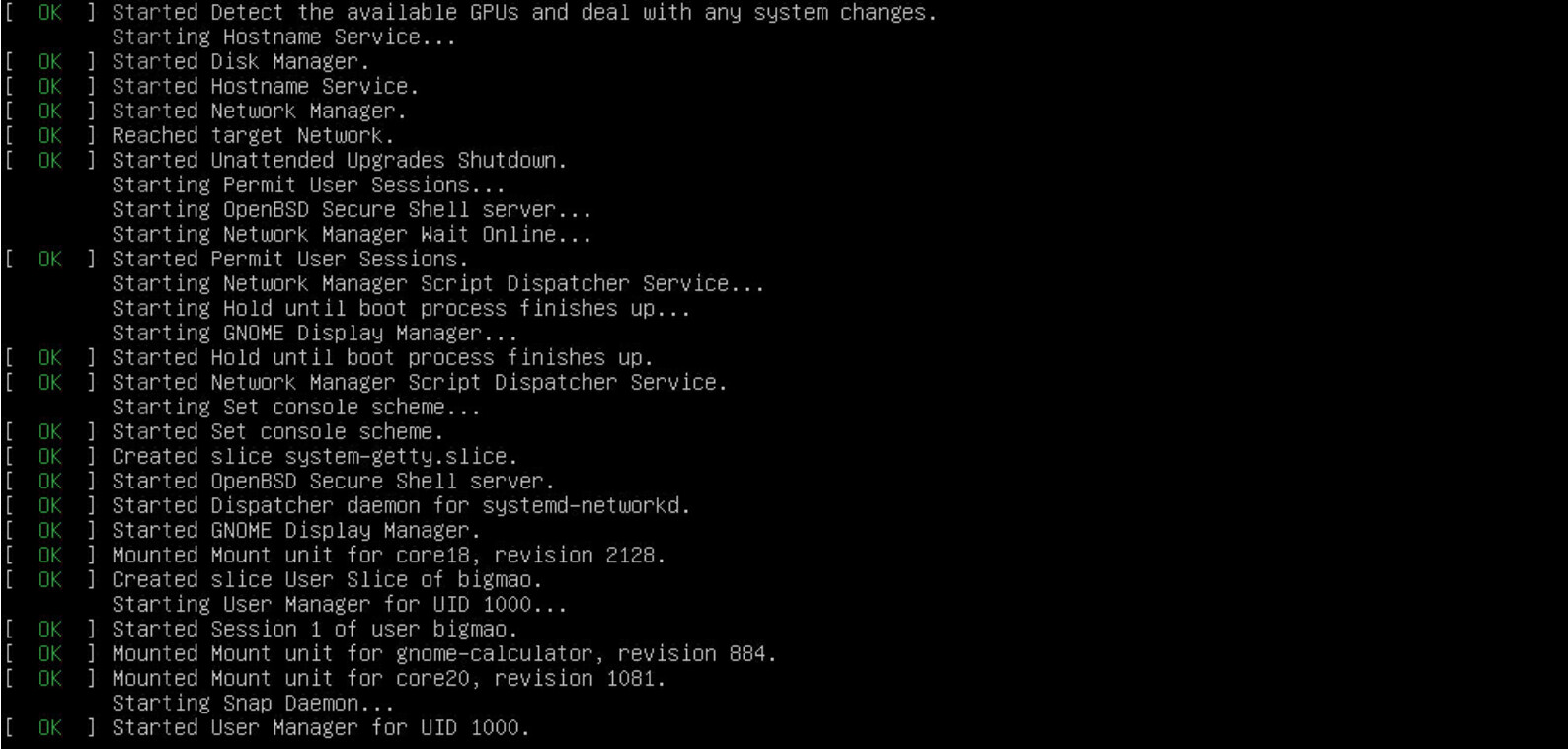

I added the BusID
restart the gdm can’t enter system,then reboot the server got this(ssh server is ok,so I can still listen to you)
Hang in here?
Can you enter into console mode?
yes Sir,delete the BusID that will recover

I found why PCI 23 into xorg.conf cause can not enter into system, I changed that to PCI 17:0:0 got a gdm login interface
