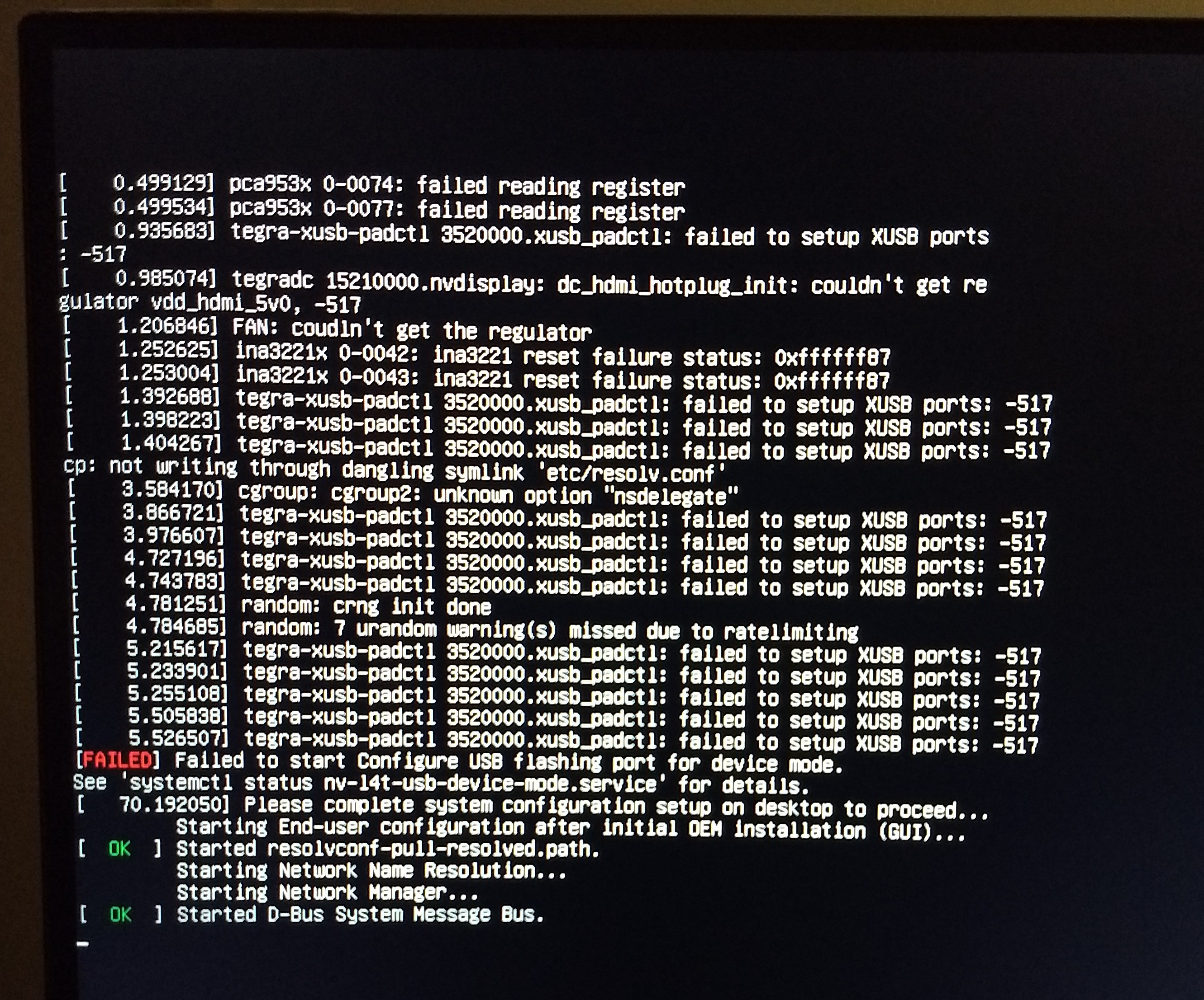

Unfortunately I’m using only module and not whole development kit. Therefore I can’t get full log but I have attached an image with important log message.
Ok I see the difference. So far I was assuming that what i’m using is dev kit carrier board. Thank you for pointing it out and explaining how the firmware might be different. I will update soon after following solution from Connect Tech Inc.
So finally I am able to flash the TX2 correctly after following instructions from https://connecttech.com/
It still follows the similar steps to flash the board with only difference in using their board support package.
