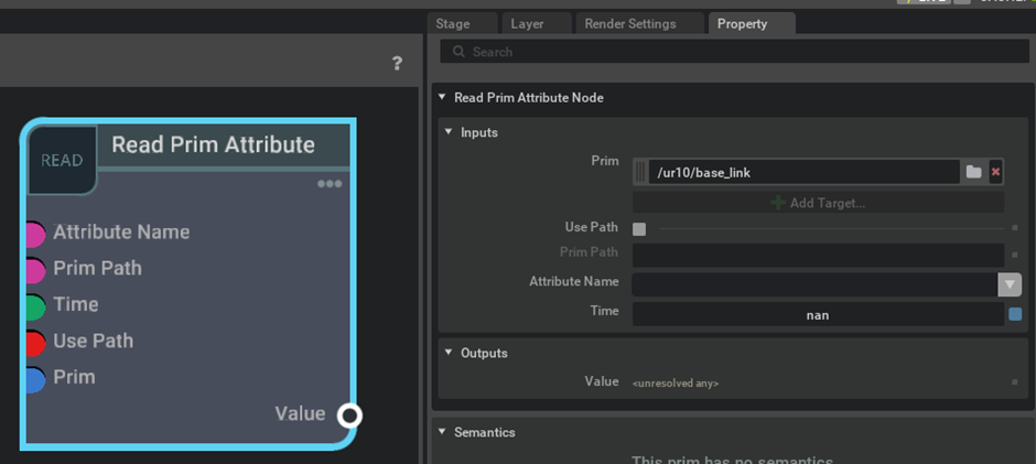

Steps to Reproduce
  1. Importing UR10 in NVIDIA localhost and adding an Action Graph.
  2. These are attributes included in the attribute Name of the Action Graph associated with the link.
pic
video
