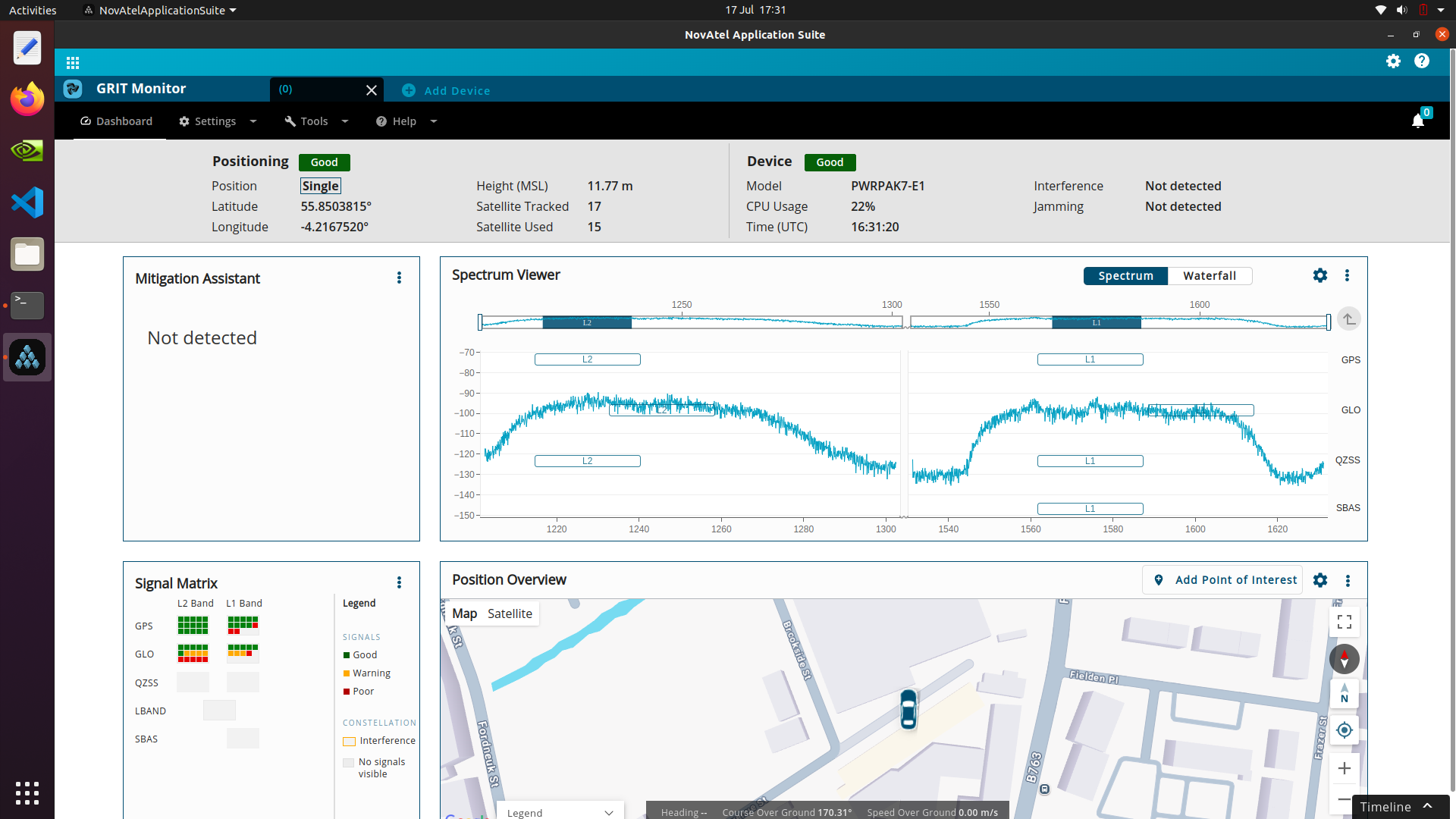

@SivaRamaKrishnaNV We are integrating a NovAtel GPS+IMU (PwrPak7, single antenna) with our NVIDIA Drive Orin platform via USB. We observed unexpected behavior during testing:
  1. Using the NovAtel Application Suite on an x86 machine, we configured the receiver to operate in Standalone mode. In this configuration, positioning and SPAN output appeared correct.
  2. However, after running ./sample_gps_logger on the Drive Orin (DriveWorks 5.20.24), several decoder errors appeared, while the IMU data stream with error: errorID(1) error messages: [IMU Alignment status error,]
  3. Upon reconnecting to the NovAtel Application Suite, we noticed the receiver had switched to RTK mode, despite no explicit configuration on our part.
We suspect the DriveWorks NovAtel decoder might be modifying the receiver configuration—possibly forcing it into RTK mode. We would like to confirm:
  • Is this behavior expected from the gps.novatel driver in DriveWorks?
  • Does the decoder modify receiver operational mode or settings upon startup?
  • What would be the solution to get the gps data?

Does that mean, You notice Operating mode value in Positioning changed to RTK from Standalone in Novatel application suite GUI after running sample_gps_logger?
Also, Is the Orin inside a moving car now?
Yes that’s right. We noticed that the mode was automatically changed to rtk mode after running the sample GPS logger. Also the orin and novatel GPS+imu were placed in a moving car.
Dear @atharv.sharma ,
This error ID(1) means the Novatel GPS sensor is not working in RTK_FIXED mode(the most precise mode for GNSS measurements)
From the shared screenshots, Novatel sensor is working in SINGLE satellite mode, which is much coarse than RTK or PPP mode w.r.t GNSS measurements. Can you first do some calibration driving and see if the sensor can go into RTK or PPP mode(given you have installed RTK software license) - move the car to open air and drive for some distance and observe again.
Basically this errorID(1) simply means the GNSS measurements(coordinates) are not very precise but the Novatel sensor as a GPS sensor is basically working.
Also, could you use ethernet instead of USB port?
