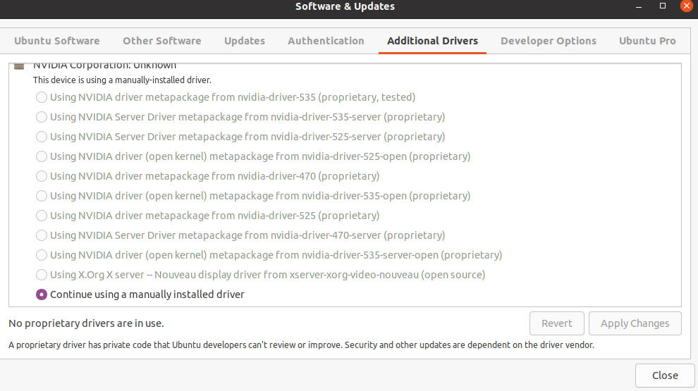

hi bro, I have the same question. my device is “ubuntu 20.04.6” “3060 12G” “driver version 535.171.04; CUDA Version: 12.2” ,
WARNING: Forcing CPU pipeline.
Not connected to PVD
Physics Engine: PhysX
Physics Device: cpu
GPU Pipeline: disabled
WARNING: lavapipe is not a conformant vulkan implementation, testing use only.
Unhandled descriptor set 433
Unhandled descriptor set 23
Unhandled descriptor set 1136766784
Segmentation fault (core dumped)
