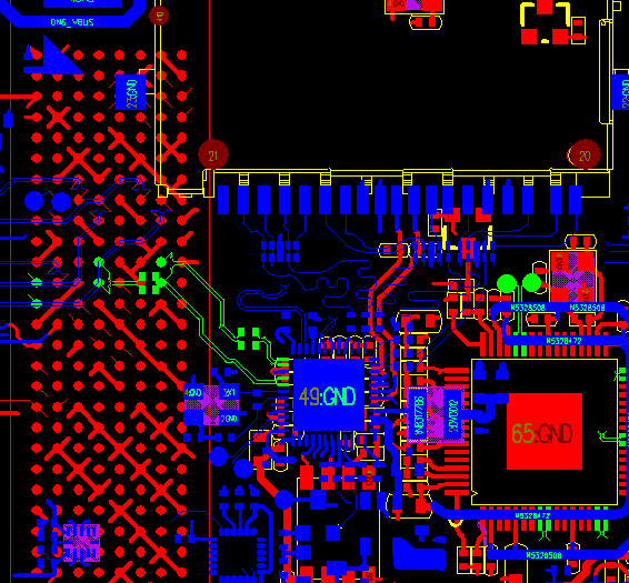

Hi DaneLLL
Yes we’re running on our own custom board, and we’re using config #4

Hi EvanKwok,
Please attach HW layout of USB lane mapping for review.
Hi DaneLLL,
Please check the attachment
Hi EvanKwok,
https://developer.nvidia.com/embedded/dlc/jetson-tx2-tx2i-oem-product-designguide
It might be an issue in the HW design of USB3 to SD in PEX_RFU. Have you checked the oem design guide?
Hi EvanKwok, please check and confirm your design had followed the “Signal Routing Requirements” of USB part in OEM DG.
Hi DaneLLL & Trumany
I let my HW engineer have a check on the document, and he didn’t find out anything wrong. Can you point out the exact problem?
You mean the impedance, trace length, pair skew, uncoupled length…etc. all match the request of OEM DG? Did you check the USB signal quality with scope? As it looks like an unstable signal issue, you’d better to check the USB signal quality first to confirm no HW issue.

No fail items seen in your report, so the signal quality should be good enough. Seems no connection issue. I have no clue from HW perspective.
