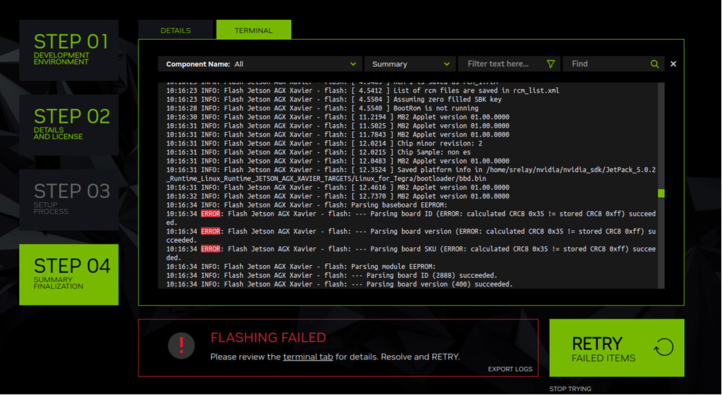

We are having trouble upgrading our AGX Xavier SOMs from JP 4.6.3 to the latest version JP 5.1.2. We are using custom config & pinmux files that can be flash successfully with 4.6.3 via command line (sudo ./flash.sh umc-gpgpu mmcblk0p1).
I have downloaded the AGX Jetpack 5.1.2 and setup the directory (just like in 4.6.3). I have copied over the custom configuration files from the successful 4.6.3 directory into the 5.1.2 directory.
When I try to flash the JP5.1.2. via the same ./flash command, I receive a ‘CPU Bootloader is not running on device error’ after some time like before and then fails to flash:

If I try to just flash directly using the SDK Manager, I receive an ID, Version, SKU error as seen below. How can I use my configuration files from my working 4.6.3 install in the new JetPack 5.1.2? I placed the files in the correct location, same as in 4.6.3, /bootloader, /bootloader/t186ref/BCT/, etc.
