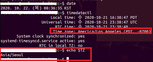

If you set the time using timedatectl like this, the time is set. However, if you change the time zone through the gui, the time of the changed time zone does not appear.
My purpose is to display the time in the format of the changed time zone even through the date command when changing the time zone through gui.
Thank you.
no.
As @WaneWWW told me
If you set the time using timedatectl, you can set the time (in the photo above, you can change it to “2020-10-21 09:47:27”, which is Seoul time, and check it through the date command. But the above answer As shown in the picture attached to, if you change the LA time zone through the gui, the time of the changed time zone does not appear.
Thank you.

After setting it manually, you can also check that the time and time zone you check through the date do not match.
If you use the echo $TZ command to check the time zone, it comes out differently.
Thank you.

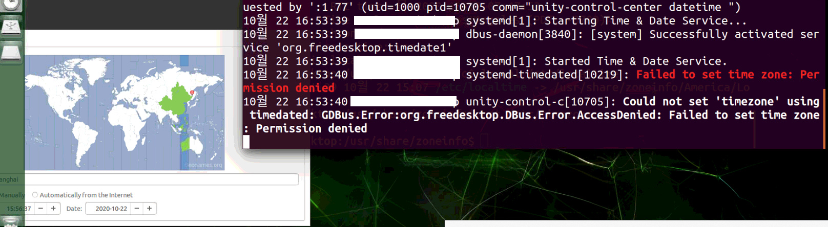

I checked with journalctl -f
As shown in red, the timezone setting is not possible due to the authority.
How do I solve this problem?
Thank you.
In nano, where the timezone is normally changed, the timezone setting is fine as follows.
Thank you.
As I understand, changing the time zone in either the GUI or using “timedatectl set-timezone” will update the following files:
  • /etc/timezone - The contents of this text file will simply be set to the relative path and name of the zoneinfo file under the /usr/share/zoneinfo/ directory (i.e. America/Los_Angeles).
  • /etc/localtime - The contents of this binary file will either be copied from the corresponding zoneinfo file or it will be recreated as a symbolic link to the named zoneinfo file.
I do not believe that the user’s TZ environment variable setting will be modified, it wouldn’t be dynamically updated in already running processes anyway. However, if the TZ environment variable has been set to a particular time zone for a user (and any running processes), that will override the system’s time zone for programs such as “date” (see https://www.gnu.org/software/libc/manual/html_node/TZ-Variable.html for more information).
Running “unset TZ” followed by the “date” command should show the “system configured” local time in that instance of the shell.
Alternatively, running “export TZ=:/etc/localtime” followed by “date” should also show the “system configured” local time, again only for that instance of the shell.
You have to be root to change the “/etc” content. Some settings are just for display for a specific account, and are not system-wide. Use sudo for commands which change the system settings, don’t use sudo for commands which just display a different timezone customization for an individual account.
