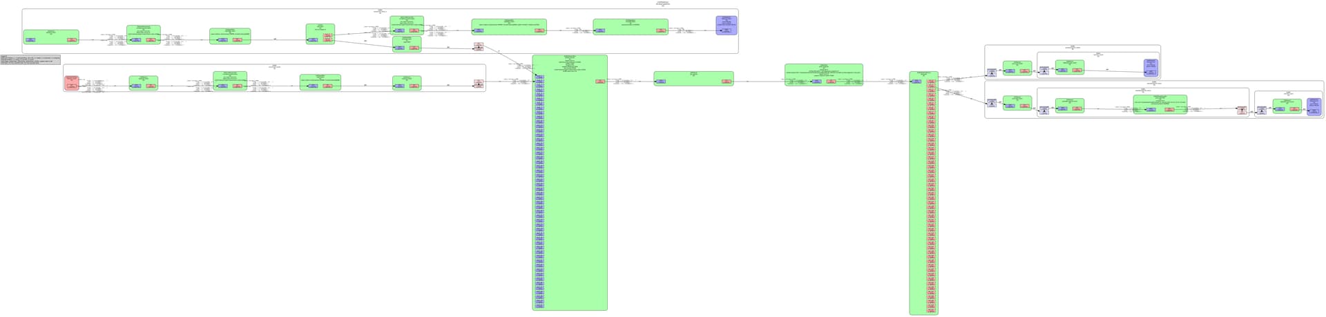

I have problem when decoding some cameras but I have not known the root cause. Do you have any idea to debug the code or stream also?
This is my error log catched from bus call
[2024-11-25 23:32:23][error][app1][main][pineline][bus] Error from element source: Internal data stream error.
[2024-11-25 23:32:23][info][app1][main][pineline][bus] Debug info: ../subprojects/gst-plugins-good/gst/rtsp/gstrtspsrc.c(6403): gst_rtspsrc_loop (): /GstPipeline:ds-base-pipeline/GstBin:source-bin-cam41_9/GstURIDecodeBin:uridecodebin-cam41/GstRTSPSrc:source:
streaming stopped, reason error (-5)
This is my pipeline.
Thank in advance.

The above picture is not clear. This issue should not be related to uridecodebin.
It seems to be caused by some bugs in your code. Please try GST_DEBUG=3 your_app > log.log 2>&1 and share the error log.
