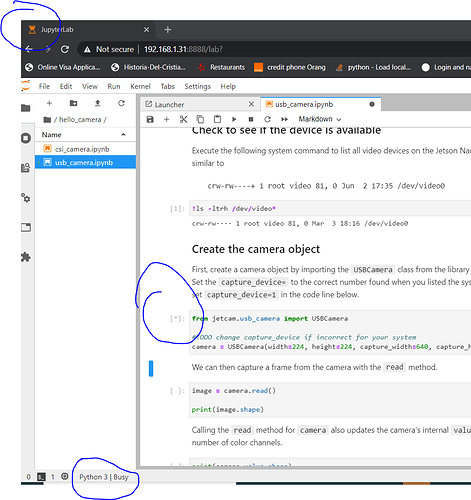

Hello I have a question I am in 1 project for classification. with getting started with jetson nano.
When I run the sell its like is pending the kernel, [*]
It showing the camera is on, but still its like still the kernel is running, for some reason., I cant continue with the next sell. why this happen any suggestion

I tried the test lab for usb camera and works at the first time, I tried again now is also in the test lab for camera and also is like pending., even after the Jupyter lab is not processing nothing the camera looks like on.(restart kernel and clear all outputs.)

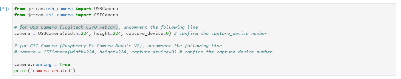

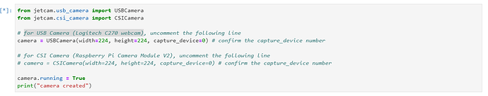

I tried the hello camera usb , the same.

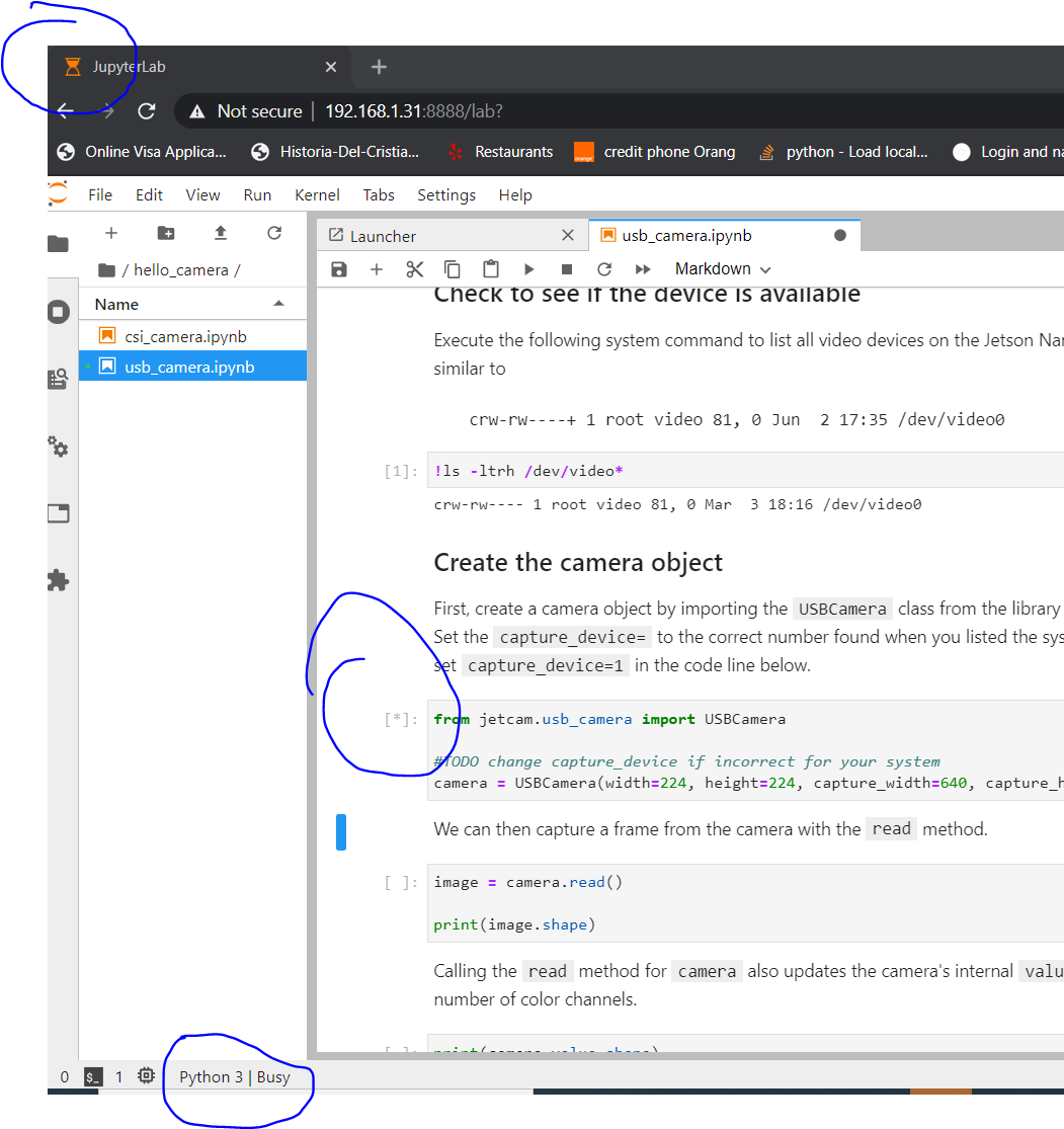

Look it stay like this alot of time, here in the screenshot.
The solution that has works for was :, for some reason the usb didnt want to work…
I have changed to the rasberri pi v2 camera,
when I run the container I just add :
–volume /tmp/argus_socket:/tmp/argus_socket
This works now , thanks for help.
