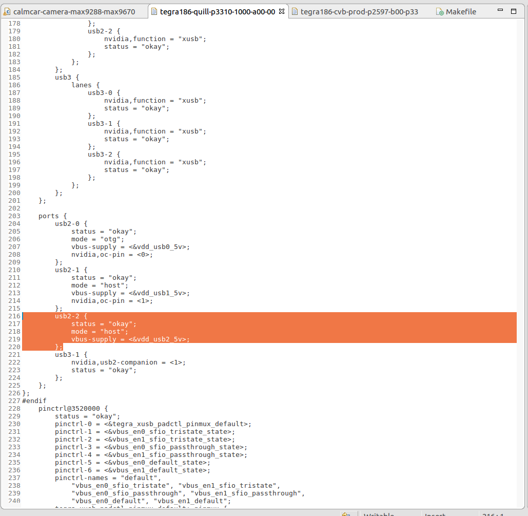

Here’s my uart boot log and dts. Dts’s line 137 to 143 and line 157 to 221 is my modification about usb

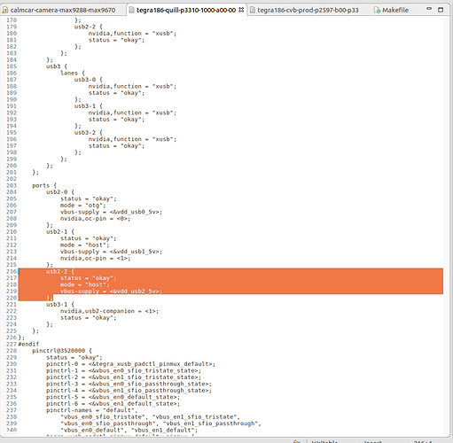

According to your log, you put usb2-2 in your pads but there is no usb2-2 in your ports.

like this ?
It cannot work. I upload my dmesg log.
It is working. The old error log is gone and we have a new one now.

Thanks for your help. I add this then solve this problem.
usb2-2 {
status = “okay”;
mode = “host”;
vbus-supply = <&battery_reg>;
