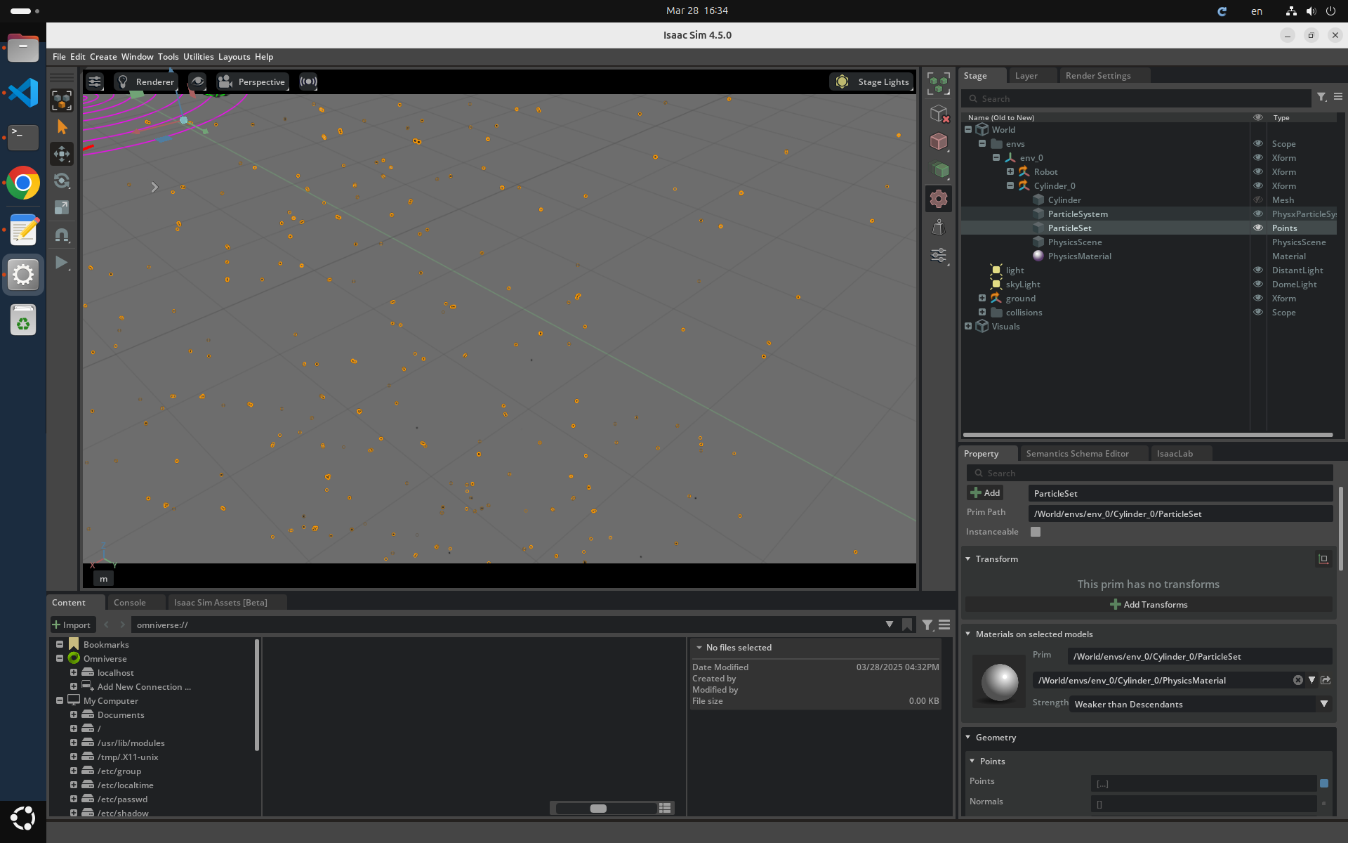

Hi, I have a USD file of a particle system that is supposed to behave like this (drop into a clump):
However, when I spawn it in a more complex environment with the spawner cfg like so,
cfg = sim_utils.UsdFileCfg(usd_path=path)
cfg.mass_props = sim_utils.MassPropertiesCfg(density=density) # the same density as original file
the particles explode immediately after the GUI loads:
The particle system is not initially touching anything else and all of the parameters are the same upon inspection. What could be some things causing this behaviour? Pointers in the right direction are greatly appreciated!
Hi @cxh3941, thanks for posting this question. I will look into this strange behavior promptly.
Michael
Actually, for me to more quickly debug this, could you share the scripts and/or usd to replicate this behavior?
Hi Michael, thanks so much for the response. I found my issue actually: we had a function that changed the scale of the imported USDs in the manager-based environment. I believe the particles were exploding because they ended up being touching after that scaling.
