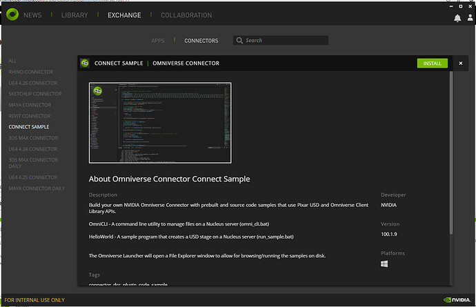

Have you looked at the example Connector included with Omniverse? It includes the source and instructions to make your own connectors.
Oh indeed I hadn’t seen this “connectors” tab in the launcher.
I will look into this, thanks!
The sample is very instructive.
