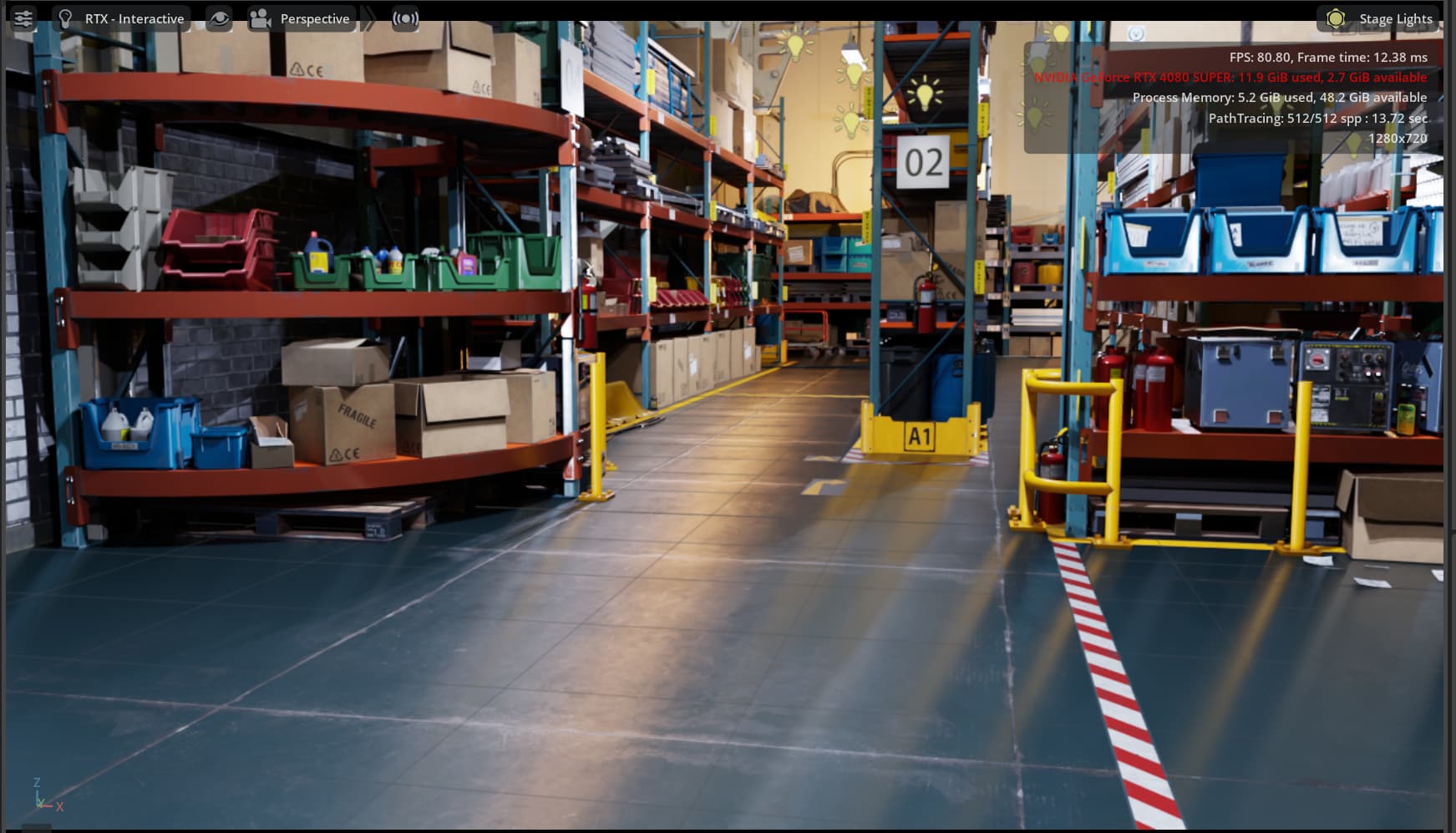

I exported a few assets from Unreal Engine 5.5 to USD for use with Isaac Sim. However, upon importing i notice that some of the geometries have incorrect surface normals (the reflections look skewed and stretched to one side or another). This happens while opening the usd directly in both Isaac and USD Composer. However, the same usd in blender does not show incorrect normals (both render or in openGL viewport).
What could be the reason for this odd behavior? How may I debug this further?

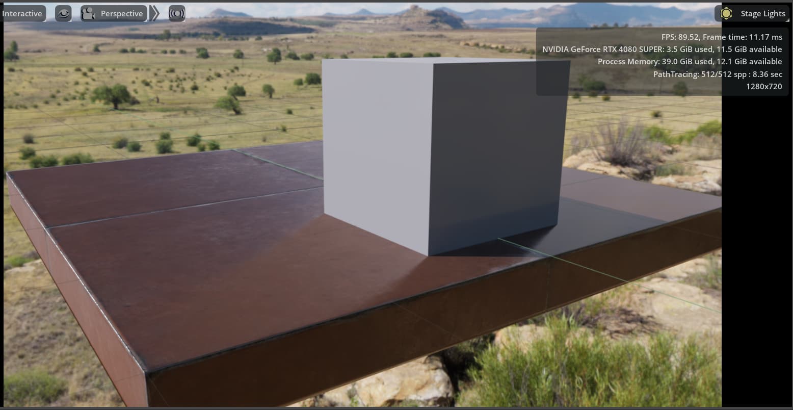

I did further debugging, with simpler objects and have found that the issue was not with geometries but with the normal maps and how they render inside of Isaac.
On a much simpler object, just a cube that’s been unwrapped, this is how it looks like:
However, upon disconnecting the normal map:

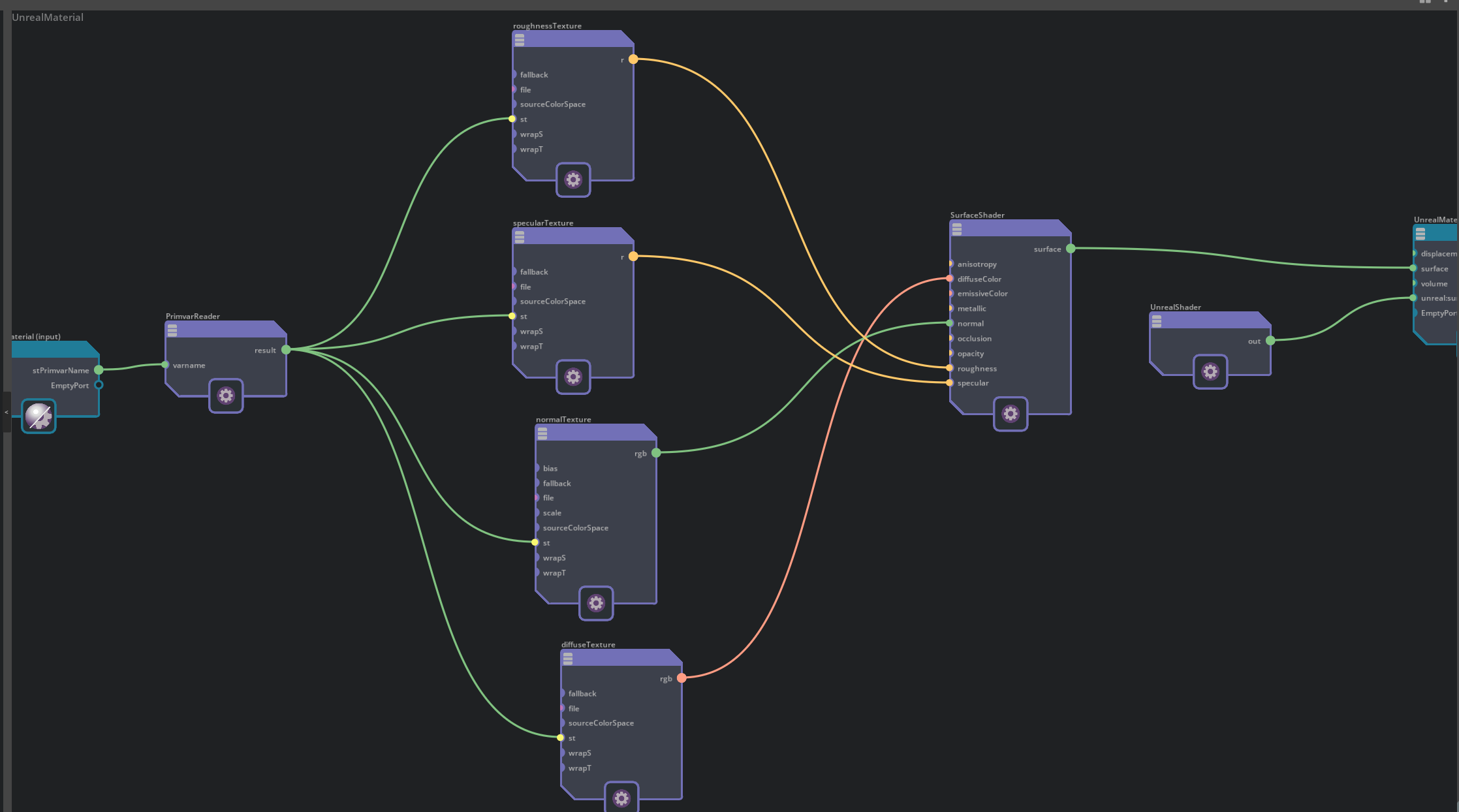

@ankit.pruthi i don’t have Isaac Sim in front of me, but could flipping the green channel of the normal map yield anything different? i can see if i can repo this when i get back to my machine. in the meantime, could you share a screenshot of your shader graph?
Here’s how the shader graph looks like. I am unable to edit this graph though.
I tried using the normal map above in a completely new shader inside Isaac as well rather than the one created from UE export but that doesn’t fix it either. Nor does flipping V.
So it is just a problem with normal maps? Normally we do the same thing. Read the normal maps with RAW Color Space.
Also we do not support Unreal Engine past 5.3. How are you exporting your scene? Through their native USD, or through FBX etc?
