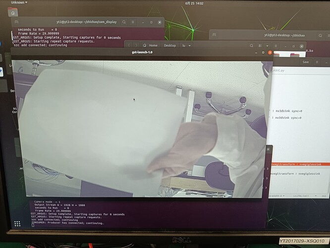

Use nvarguscamerasrc to show image. The image has color deviation
use nvarguscamerasrc to show image. The image has color deviation.

Do you know how to eliminate the color deviation?
The picture is captured by nvarguscamerasrc. There is color deviation. White is not pure white.

The camera is IMX678 at this time. IMX678 is auto exposure. Color deviation is more obviouse.

IMX390 exposure is too much. High exposure makes all color to be white.
The first picture is captured by nv3dsink command.
The second picture is captured by nveglglessink.
The color of A4 paper in the picture is pure white in fact. But the color is not pure white from two pictures.
Suppose it could be over exposure cause the problem.
No. Now there is no over exposure. But the color deviation is obviouse.

The color type of the camera is RGGB. Use opencv to do white balance, there is no color deviation.
nvarguscamerasrc changes the color type from RGGB to NV12, then different sinks all show color deviation image.
I think the issue is from the nvarguscamerasrc.
Right, that’s why need image tuning for ISP pipeline.
I don’t understand why camera needs image tunning for ISP pipeline. I think nvarguscamerasrc needs to be checked. How does nvarguscamerasrc change rggb to NV12? Perhaps the formula is not correct.
