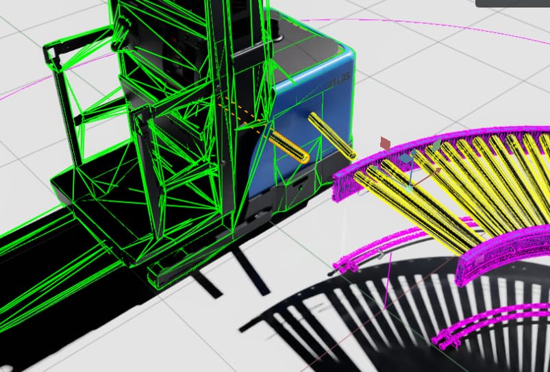

  1. Load one asset (forklift_b.usd)
  2. Load one asset (any conveyor belt)
  3. Try using one mesh of the conveyor belt (say a Roller) to replace a mesh in the forklift.
  4. Fail

The full context is that I have a complex rigged robot that I want to replace some of the meshes with the meshes of another asset.

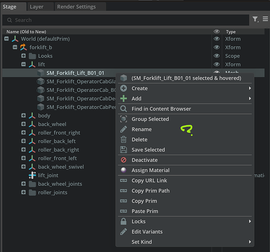

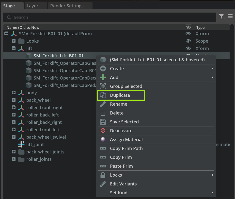

below are screenshots of the differences when you are working with the source USD vs references:
Source file (forklift_b.usd):
forklift_b.usd being used as Reference/Payload:
