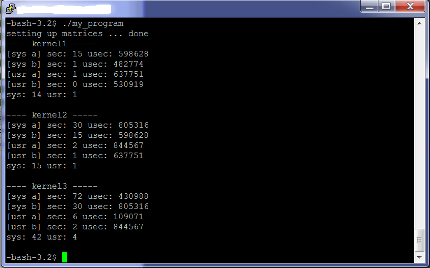

usec and sec times in cuda
I ran the below code and get an output as the following (attached).
The main issue is that the usec values and sec values are not equivalent and they should be. I thought usec was microseconds and sec in seconds, however they do not correspond. Im trying to find out how long the kernal is employed for in each kernal invocation.
Any help would be greatly appreciated.

The two fields do not encode the same time in different units (the usec field would overflow within less than an hour). Rather, the actual time is the sum of the seconds and microseconds values.
