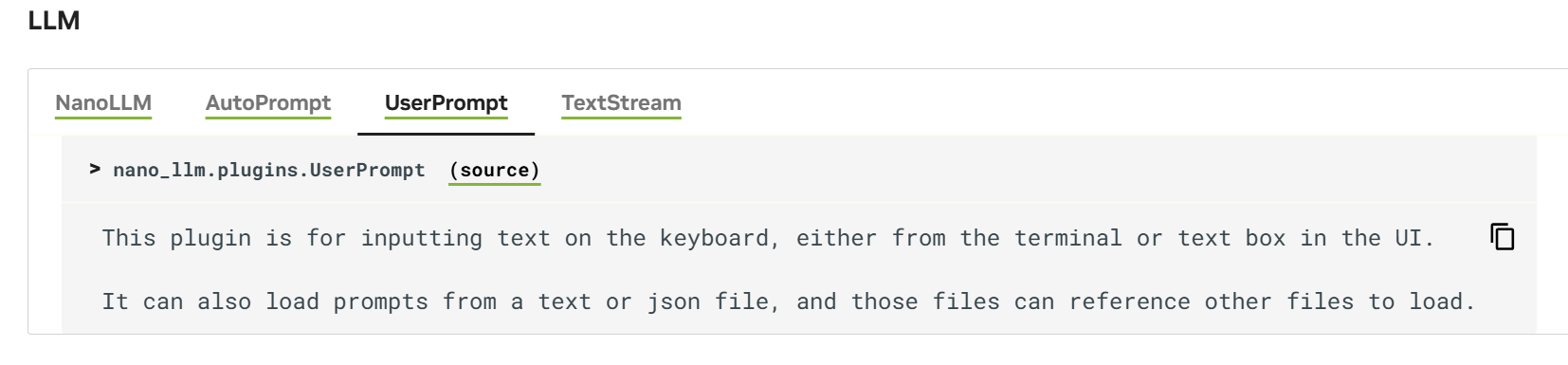

Hello NVIDIA,
As described in the Agent Studio AI labs page, how can I use the UserPrompt node to add files from the terminal for the model to interpret? This is the UserPrompt within the Agent Studio Node Editor.
 ![image](https://global.discourse-cdn.com/nvidia/original/4X/2/f/3/2f353ad9cac987036d3afe60d1c319764e113c68.png)
Thank you in advance!

You can find an example to use the plugin below:
[https://github.com/dusty-nv/NanoLLM/blob/main/nano\_llm/agents/chat.py](https://github.com/dusty-nv/NanoLLM/blob/main/nano_llm/agents/chat.py)
Or this can be tested with _nano\_llm.chat_ directly:
> **[Installation — NanoLLM 24.7 documentation](https://dusty-nv.github.io/NanoLLM/install.html#running-models)**
```bash
$ git clone https://github.com/dusty-nv/NanoLLM
$ jetson-containers run -v ${PWD}/NanoLLM:/opt/NanoLLM $(autotag nano_llm)
```auto
$ python3 -m nano_llm.chat --model meta-llama/Llama-2-7b-chat-hf --api=mlc --quantization q4f16_ft
05:51:18 | INFO | using chat template 'llama-2' for model Llama-2-7b-chat-hf
05:51:18 | INFO | model 'Llama-2-7b-chat-hf', chat template 'llama-2' stop tokens: ['</s>'] -> [2]
>> PROMPT:
