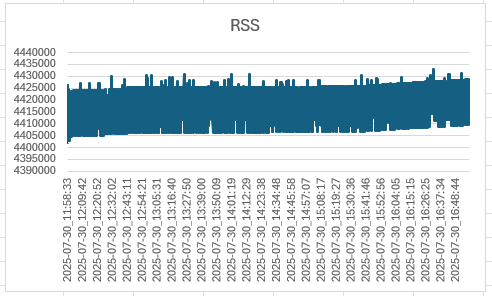

I ran nano_llm.vision.video of the NanoLLM application using the docker image dystynv/nano_llm:r36.3.0.
After running the application for 5 hours and checking RSS, I found that there is a memory leak.
Could you tell me how to fix memory leaks?
Following the issue in the link below, which is a known memory leak problem, I have already added gc.collect.
Additionally, since I do not need the video output, I have deleted the code related to the video_output variable.
Please check video.py in Relevant Files for changes to /opt/NanoLLM/nano_llm/vision/video.py.
When not using TensorRT models, there were hardly any memory leaks.
Therefore, using the TensorRT model causes memory leaks.

The following log file is a log of the RSS when running VLM with the TensorRT model.
psinfo.log (1.2 MB)
Additionally, the following log file is a log of the RSS when running VLM without using the TensorRT model.
psinfo.log (1.2 MB)
