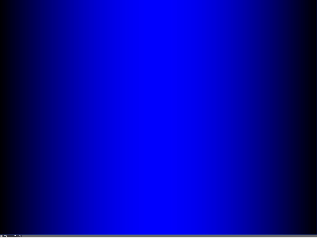

Yes, I can confirm, that after running an OptiX Kernel which accesses only an OptiX source buffer (as you described), the dev2dev copy also succeeds on my system and the values are valid (using float4 buffers dimension 1024x768; CUDA 10.0; OptiX 6.0.0)
I initialized the first float of all the float4’s of the source optix::buffer (type RT_BUFFER_INPUT_OUTPUT) with sin(((float)x / (float)width) * M_PI) ;
then ran an OptiX kernel which has a read access to that buffer (and copies that data to another buffer; that other buffer is later ignored; but without it nvcc may compeltely optimize the memory access away, cause it would be senseless)
then I do the dev2dev as you said (target optix::buffer type: RT_BUFFER_INPUT).
and then that optix::Buffer (type RT_BUFFER_INPUT) is copied through a CUDA kernel into a DirectX11 StructuredBuffer;
The result then is read by a HLSL shader as a SRV and the pixel shader then outputs the color in the blue channel. No errors, no exceptions. So far so good. (see attachment)
But:
Attaching this RT_BUFFER_INPUT optix::Buffer to an optix::TextureSampler fails:
OptiX Error: ‘Invalid value (Details: Function “_rtTextureSamplerSetBuffer” caught exception: Buffers used as both buffer and texture are not supported)’
And so its clear: in the current OptiX versions a buffer either can be used as Buffer xor as an attachment in a TextureSampler.
So unfortunately then an each-frame-updated-texture only can be updated/accessed through a pure buffer yet. (Or over the host GPU=>CPU=>GPU)
