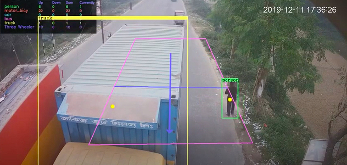

Although we had existing vehicle counter developed for windows pc, which was not great , but this current design with Jetson running at almost 60fps, which very good in terms of customer satisfaction.
The Vehicle counter uses Yolo model and trained with 15000 images of vehicle.
Due to low cost Hardware Jetson Nano, we able to deliver this cheap solution to our customer.
Here is the video demo from the toll plaza installed at Bangladesh >> Vehicle Counter & Classifier - Traffic Management Solutions by Kotai Electronics - YouTube
