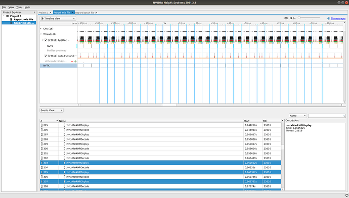

I tried to use the NVTX marker as suggested.
In the attachments you can find the reports generated using Nsight and some screenshoots that highlight the marker within the timeline.

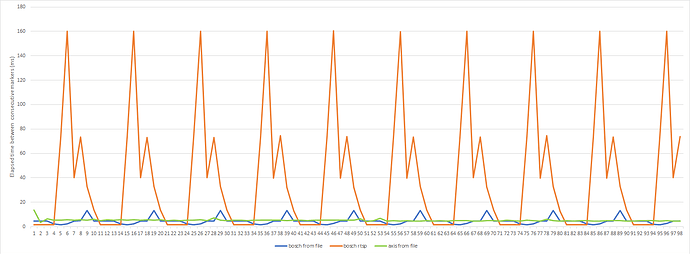

I also uploaded an image of a line chart that shows a comparison among Bosch (reading from file) - Bosch (reading from rtsp) - Axis (reading from file), of the elapsed time between two consecutive marker points placed within the `HandlePictureDisplay` function.
I have taken 100 consecutive marker samples from those generated by NSight.
The X-axis represents the frame number.
The Y-axes represents the value of elapsed time between two consecutive marker points in milliseconds.
As you can see the unexpected results from the Bosch Camera are well visible, because it shows a high variability between consecutive marker points. Instead I would expect to have an almost straight line (this would mean that the `HandlePictureDisplay` would be invoked with regularity.

comparison\_bosch\_axis (elapsed time between consecutive markers)
 ![comparison_bosch_axis](https://global.discourse-cdn.com/nvidia/original/3X/e/2/e2ef44f117e175b0ed2b2479878a01b6d9ffc2a6.png)
Screenshot nsight axis reading from file
 ![Screenshot nsight axis file](https://global.discourse-cdn.com/nvidia/original/3X/7/b/7b0934f165e08661963bb87b21bed51ec5a7a067.png)
Screenshot nsight bosch reding from file
 ![Screenshot nsight bosch file](https://global.discourse-cdn.com/nvidia/original/3X/4/2/4252f7a8f045564186da3a35b154467dee6168f0.png)
Screenshot nsight bosch reading from RTSP
 ![Screenshot nsight bosch rtsp](https://global.discourse-cdn.com/nvidia/original/3X/f/2/f2e009bbc16463ba69ae0d15e9d066e95f4439ca.png)
