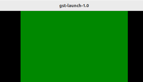

However, I’m getting a green screen when I try to run the video:
~$ gst-launch-1.0 v4l2src device=/dev/video0 ! xvimagesink
Pipeline is live and does not need PREROLL ...
Pipeline is PREROLLED ...
New clock: GstSystemClock
WARNING: from element /GstPipeline:pipeline0/GstV4l2Src:v4l2src0: Signal lost
Additional debug info:
../sys/v4l2/gstv4l2src.c(556): gst_v4l2src_query_preferred_size (): /GstPipeline:pipeline0/GstV4l2Src:v4l2src0:
No input source was detected - video frames invalid
Redistribute latency...
Using oscilloscope, I verified that the analog video is being input, but there’s no activity on the MIPI CSI lines (clk and data both).
Any idea how to solve this?
Thank you.
I think you need to check you HW connection.
Seems ADV7280m is not correctly configured. You may need tocheck with vendor for root cause first.
Ive checked, the hardware connection seems correct.
