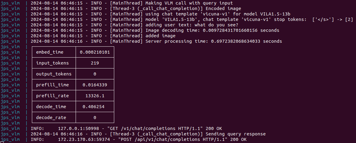

VILA1.5 13B somtimes will return empty value
I’m using AGX Orin 64G to try the JPS vlm service.
I call the chat completion api to ask the model to describe the image. But sometime it would return the empty value.
I have tried the llava 1.5 13B, and there was not the same issue.
How can I solve this problem?

I think the problem is the order of the content.
The content I used before is:
"content":[
                "type": "stream",
                "stream":
                    "type":"text",
                    "text": "Can you describe the scene?"
                    "stream_id": "a782e200-eb48-4d17-a1b9-5ac0696217f7"
The issue have solved after I change the order of the content.
Thank you!
