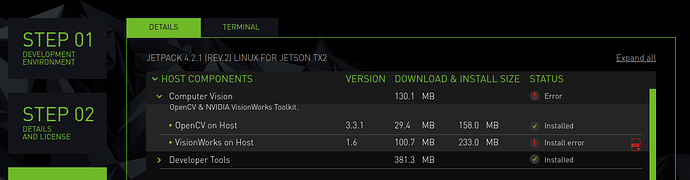

While Installaing Jetpak 4.2.1 rev2 on Jetson TX2 using SDK Manger, Facing an issue wrt “Visionworks installation on Host failed”, due to which in Summary it shows the Installation Falied.
Tried clean installation as well, issue still persists.

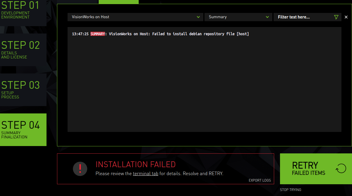

In terminal it shows -
Version ‘1.6.0.500n*’ for ‘libvisionworks-dev’ was not found
13:47:25 SUMMARY: VisionWorks on Host: Failed to install debian repository file [host]

- 13:47:25 INFO: VisionWorks on Host: E: Version ‘1.6.0.500n*’ for ‘libvisionworks-dev’ was not found
- 13:47:25 INFO: VisionWorks on Host: [ Package Install Finished with Error ]
- 13:47:25 INFO: VisionWorks on Host: [ 16.00 KB used. Disk Avail: 255.65 GB ]
- 13:47:25 INFO: VisionWorks on Host: [ NV_VISIONWORKS_HOST_COMP Install took 21s ]
- 13:47:25 SUMMARY: VisionWorks on Host: Failed to install debian repository file [host]
Summary Info Image -
