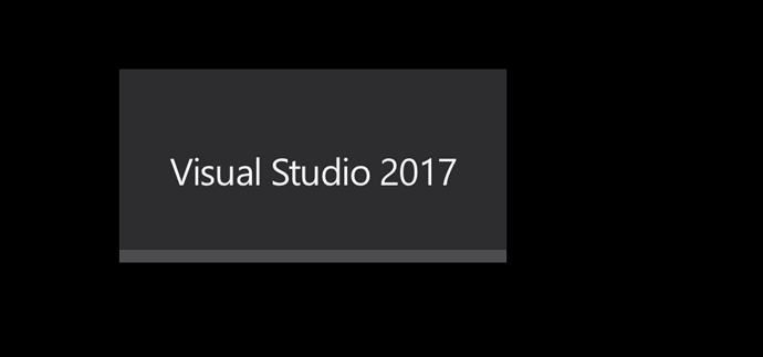

Hi Mikhail,
Since vslogs potentially contains identifying information, I will e-mail you the password to the protected zip archive
Please note that this has been run after manually installing the vsix
Here is what happens when I attempt to run vs 2017 not in administrator mode
 ![NvidiaTegra3.5VS2017NonAdminCrash.gif](https://global.discourse-cdn.com/nvidia/original/3X/d/7/d7ff356a482bd304aa702e0fe91b0ea98e493ebc.gif)

Thank you, but unfortunately:
1. The password that you’ve sent me doesn’t work
2. I’m unable to reproduce the crash issue depicted in the GIF.
Please, share the exact versions of Windows and VS 2017 that are installed on the PC where the problem is reproduced.

I can’t reproduce the crash depicted on your GIF on Windows 7 and 10. Maybe it’s caused by the intervention of AV/security software installed on your PC.
It’ll help a lot if you tweak Windows Error Reporting to capture the full memory dump of devenv.exe and share it with me.
Here’s how to configure WER to capture user-mode dumps: [Collecting User-Mode Dumps - Win32 apps | Microsoft Docs](https://msdn.microsoft.com/en-us/library/windows/desktop/bb787181)
