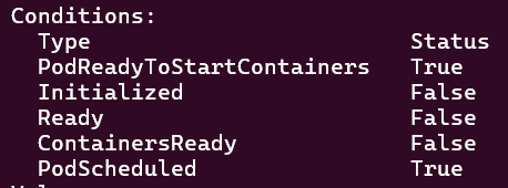

The last two pods are also not in the “READY” state. Could you please attach the logs together?
vss-blueprint-0 Pods:
You may find the logs in vss_logs.txt:
vss_logs.txt (14.3 KB)
vss-vss-deployment-649f65b85d-6vmdk
This pod is not initialized so there are no events and logs. Here is some information you may find useful:

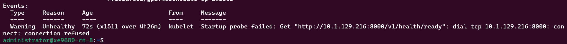

Hi, I managed to fix the nemo pods issues by extending the initialDelaySecond to 500s. However, the vss-blueprint-0 and vss-vss-deployment-649f65b85d-hqmrg are still faces issues.
Unlike nemo embedding pods, the vss-blueprint-0 kept on failing startup probe.
While the logs do not have any abnormal message.
vss-blueprint_logs.txt (14.4 KB)
I have tried to extend the initialDelaySecond of the startup probe for vss-blueprint-0 but the pods configuration did not update despite I have replace the pods forcefully. I wanted to modify its deployment, but I don’t find it.

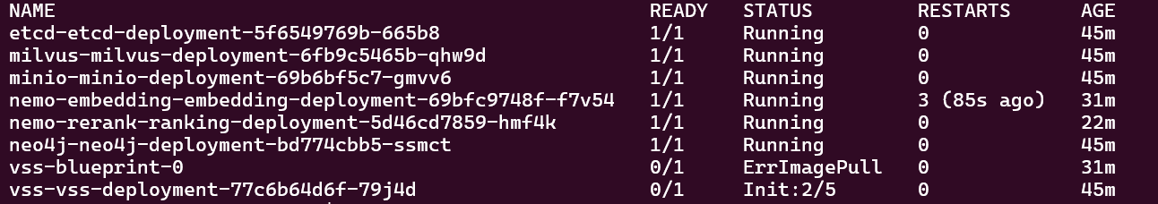

Could you try the fully-local-single-gpu-deployment first? The resource that needs to be downloaded is relatively small in this way.
Hi, I tried with single gpu deployment but it seems to have different issues where it fails to pull the image in vss-blueprint-0. The nemo embedding pods also have the same issues again even though I have update the initialDelaySecond.
