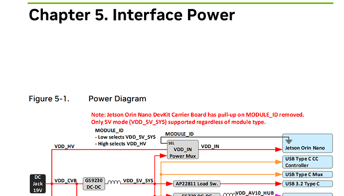

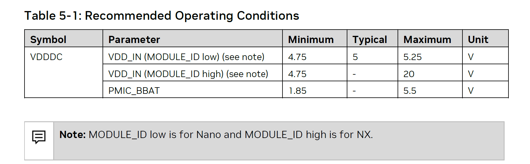

Hi all,
I run my jetson orin nano with 12v DC battery. I want to extract or read the input voltage the jetson is getting. For that i follow the nvidia documentation and refer to this folder:$ cat /sys/bus/i2c/drivers/ina3221/1-0040/hwmon/hwmon/inx_input . And it was so confused to see which one is input voltage as there are 7 in_1..7_voltage. then i tried to read the voltage of all and get the output as:orin@orin-desktop:~$ ./voltage_input.sh
in1_input: 5080 mV
in2_input: 5072 mV
in3_input: 5080 mV
in4_input: 5320 mV
in5_input: 1200 mV
in6_input: 1360 mV
in7_input: 10920 mV
since the in7_input is close to 9-19v i assume this as input main supply. And then i start reading in7_input in every 1ms. and i get some surprise outputs:Wednesday 02 April 2025 04:51:02 PM IST: 14.88 V
Wednesday 02 April 2025 04:51:02 PM IST: 8.68 V
Wednesday 02 April 2025 04:51:03 PM IST: 7.92 V
Wednesday 02 April 2025 04:51:03 PM IST: 12.60 V
Wednesday 02 April 2025 04:51:03 PM IST: 11.04 V
Wednesday 02 April 2025 04:51:03 PM IST: 9.32 V
Wednesday 02 April 2025 04:51:03 PM IST: 11.12 V
Wednesday 02 April 2025 04:51:03 PM IST: 7.56 V
Wednesday 02 April 2025 04:51:03 PM IST: 13.00 V
Wednesday 02 April 2025 04:51:03 PM IST: 9.60 V
Wednesday 02 April 2025 04:51:04 PM IST: 8.00 V
Wednesday 02 April 2025 04:51:04 PM IST: 12.20 V
Wednesday 02 April 2025 04:51:04 PM IST: 11.08 V
Wednesday 02 April 2025 04:51:04 PM IST: 11.28 V
Wednesday 02 April 2025 04:51:04 PM IST: 10.40 V
Wednesday 02 April 2025 04:51:04 PM IST: 9.04 V
Wednesday 02 April 2025 04:51:04 PM IST: 8.52 V
Wednesday 02 April 2025 04:51:04 PM IST: 7.68 V
As we know jetson runs or operates between 9-19v. But in my output you can see voltage less than 9v. And i mentioned earlier , my power supply battery is 12v , even i see output as 13v and 12.2v that is more than 12v. How is it possible? Am i missing something.
Any insights and leads on this will be helpful . Thank you in advance
Best,
Amar
Refer to Jetson Orin Nano Series data Sheet https://developer.nvidia.com/downloads/jetson-orin-nx-module-series-data-sheet
Which Jetson module are you using Jetson Orin Nano or Jetson Orin NX? The Carrier Board supports both Jetson Orin Nano and Jetson Orin NX modules.
Also refer to Jetson Orin Nano DevKit Carrier Board Specification https://developer.nvidia.com/downloads/assets/embedded/secure/jetson/orin_nano/docs/jetson_orin_nano_devkit_carrier_board_specification_sp.pdf
Refer to Jetson Orin Nano Series, Jetson Orin NX Series and Jetson AGX Orin Series — NVIDIA Jetson Linux Developer Guide
