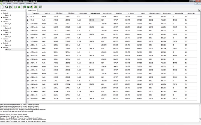

I have a strange problem, I am writing a raytracing app and this problem only seems to manifest itself with transparent objects. I read a previously post saying that warp serialises have nothing to do with branching, but to do with accesses to constant memory and shared memory - I’ve edited my program to not use constant memory or shared memory now, everything is stored in textures, and yet I am still getting warp serialisation. Any ideas anyone?
If you need to see any code let me know.
Here is the profiler output (attached):
I’ve narrowed the problem down a bit now, and I think it has some thing to do with some local memory arrays in my shading code:
