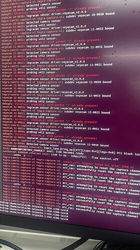

Scene Description:
AGX Orin kit
GMSL Des 96712 + Ser 9295 1080p camera
JP5.x版本 dts,capture ok,but update to JP6.1 canot capture
compatible = “nvidia,veyecam”;
reg = <0x50>;
devnode = “video0”;
                    /* Physical dimensions of sensor */
                    physical_w = "5.6";
                    physical_h = "3.1";
                    /* Define any required hw resources needed by driver */
                    /* ie. clocks, io pins, power sources */
                    avdd-reg = "vana";
                    iovdd-reg = "vif";
                    /* Enable EEPROM support */
                    has-eeprom = "0";
                    mode0 {
                    mclk_khz = "24000";
                    num_lanes = "4";
                    vc_id = "0";
                    phy_mode = "DPHY";
                    discontinuous_clk = "yes";
                    dpcm_enable = "false";
                    cil_settletime = "0";
                    active_w = "1920";
                    active_h = "1080";
                    mode_type = "yuv";
                    pixel_phase = "uyvy";
                    csi_pixel_bit_depth = "8";
                    readout_orientation = "0";
					line_length = "1920";
					inherent_gain = "1";
					mclk_multiplier = "5.184";
					pix_clk_hz = "124416000";
					serdes_pix_clk_hz = "700000000";

Get the trace log to check.
sudo su
modprobe rtcpu_debug
echo 1 > /sys/kernel/debug/tracing/tracing_on
echo 30720 > /sys/kernel/debug/tracing/buffer_size_kb
echo 1 > /sys/kernel/debug/tracing/events/tegra_rtcpu/enable
echo 1 > /sys/kernel/debug/tracing/events/freertos/enable
echo 3 > /sys/kernel/debug/camrtc/log-level
echo 1 > /sys/kernel/debug/tracing/events/camera_common/enable
echo > /sys/kernel/debug/tracing/trace
v4l2-ctl --stream-mmap -c bypass_mode=0
cat /sys/kernel/debug/tracing/trace
Copy to trace log and upload it.
trace.log (31.6 MB)
The CHANSEL_NOMATCH could be incorrect embedded_data_height in sensor dts file.
JP5.x set embedded_metadata_height = “0”;
Now JP6.1 also set embedded_metadata_height = “0”
Other GMSL 96712 reg config also same
It still hasn’t been resolved.
The CHANSEL_NOMATCH could be the embedded data or virtual channel id cause it.
Now I really don’t know how to debug it.
The DTS parameter configuration remains exactly the same as in JP5.x.
However, no images are generated no matter what.

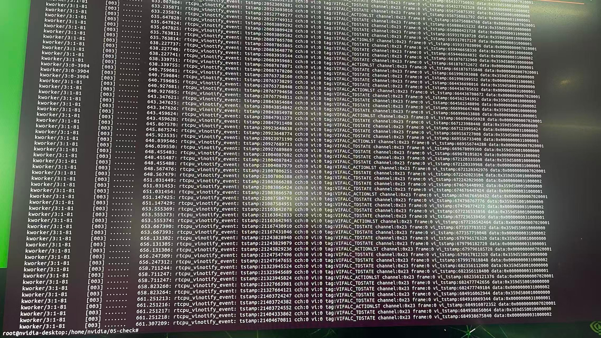

Can you confirm the trace log on JP5.x to confirm the CHANSEL_NOMATCH only happened on JP6.x?
JP5.x no CHANSEL_NOMATCH, cap ok
Now JP6.0
I add vc-id<0/1/2/3> in VI config
The trace is as follows
trace.log (5.6 KB)
The “CHANSEL_NOMATCH” trace has been removed, but the issue still persists and no diagram can be generated.
All other GMSL configurations are normal, exactly the same as the JP5.x configuration.
The log shows didn’t receive any validate data from the sensor.
I measured the MIPI output with my oscilloscope and it was normal.
The status of GMSL96712 is also normal.
The pix_clk_hz and des_pix_clk_hz in DTS are exactly the same as those in the JP5.x version.
Has the dts parameter requirement for JP6.0 changed?
