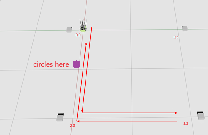

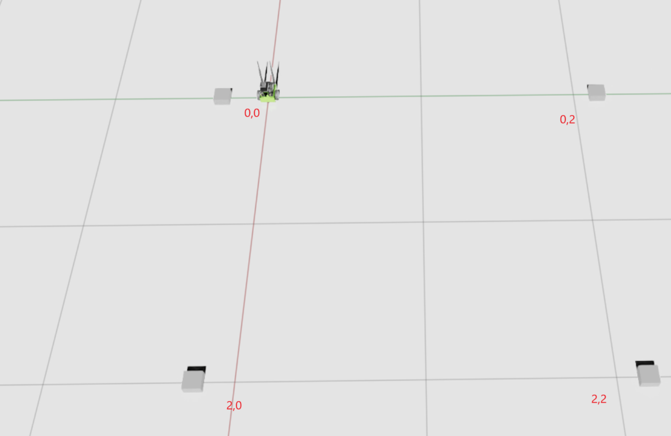

I have created jetbot navigation using Tasks based on the tutorial - What Is Isaac Sim? — Isaac Sim Documentation. The high-level concept is robot goes around in a square path. The robot starts at 0,0 then goes to 2, 0 then goes to 2, 2 then goes to 0, 2 and finally back to 0,0. An illustration below. The cubes are added for reference purpose only.
The robot goes from 0,02,02,2 without any issues. The error occurs while navigating from 2,2 to 0,2. After reaching halfway, the robot keeps rotating endlessly. Please see the attached video for more details.
I logged position of the jetbot and values are 0.937..., 1.997....
Now, coming to the logic side. I am continuously checking how close is robot to the next immediate goal in get_observations() of Task. If it is close to the goal, I am changing the goal of the jetboat to next goal position. This goes on.
Here is reference code snippet. Few codes are ommitted for readability.

What I observed is when the robot starts rotating, the orientation z-axis value changes continuously. I am not setting anything other than position. However, it looks like something is influencing the robot’s orientation. I replaced JetBot robot with IW robot. It is also behaving same and rotates while moving from 2,2 to 0,2.
Screenshots or Videos
Any thought on why robot keeps rotating and how to make this work?
Thanks in advance.
I did some more research. I changed the goal from 0,02,02,22,00,0.
This time, the robot starts circling while going from 2,00,0.
So, it looks like navigating from bottom to top is causing some issues.
Any thoughts?
