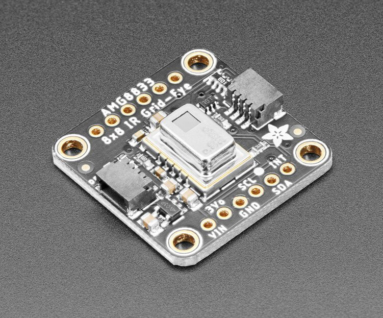

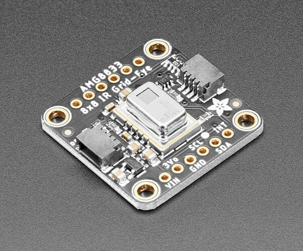

It would be much more user friendly if there was just a pdf or image that could be downloaded with the board design, similar to how Adafruit provides it for all of their boards:
https://learn.adafruit.com/adafruit-amg8833-8x8-thermal-camera-sensor/downloads
