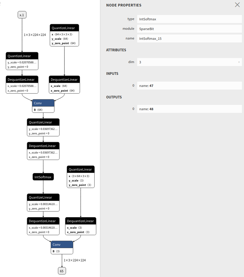

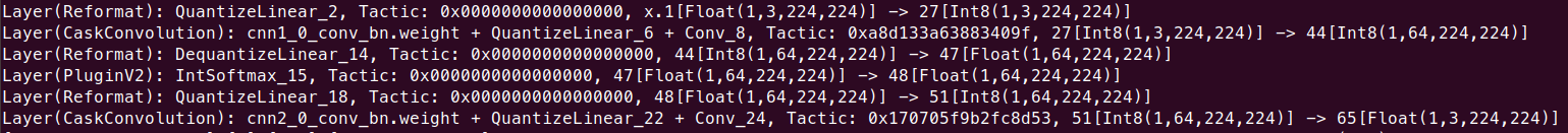

I wrote a custom plugins to support int8 input, but the log of trtexec --verboseshows that a dq->my_op->q combination, which is expected to be fused as a my_op_int, is not fused together. The toy onnx model and trt model after fusion is shown below.
It is said that custom plugins can’t be fused with other operators. I am wondering whether the custom plugins can be fused with qdq to construct a custom int8 operator. If so, how can I create a custom qdq fusion? Or if there’s any way telling tensorrt whether fuse a qdq operator with custom plugin or not?

Plugins in TRT replace a group of layers with a proprietary implementations. You, the user, decide what functionality to include in the plugin and what to leave for TRT to handle.
The same idea follows for a TRT network with Q/DQ layers: if you want your plugin to get quantized int8 inputs and outputs, then you need to include the input DQ and output Q as part of your plugin and remove them from the network you define for TRT.
Let’s look at your example (ignoring weights quantization):
Q → DQ → Conv → Q → DQ → IntSoftMax → Q → DQ → Conv.
I’ll indicate TRT fusions using square brackets and show what you are getting today:
Q → [DQ → Conv → Q] → DQ_i → IntSoftMax → Q_o → [DQ → Conv].
I’m suggesting that you manually “fuse” DQ_i and Q_o with IntSoftMax so TRT will see a network like this:
Q → DQ → Conv → Q → IntSoftMax → DQ → Conv
Which it will fuse to:
Q → [DQ → Conv → Q] → IntSoftMax → [DQ → Conv].
When you “manually fuse” DQ_i you take the input quantization scale and give it to your plugin so it will know how to dequantize (if needed) the input. The same follows for using the scale from Q_o in order to quantize your plugin’s output.
Thanks for your reply!
We tested this manually fusing method and it works.

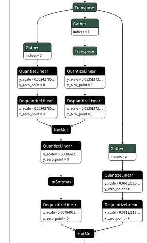

Although the manually fusing method works well on the above toy model, another bug reported when we apply it to DeiT.
The DeiT model with inserted QDQ module can be successfully built by trtexec. However, when we manually replace onnx.softmax with our custom int-softmax and manually remove the dq and q before and after custom int-softmax, the engine is not built successfully.
The above image shows a typical multi-head-attention module in Transformer with QDQ inserted. Softmaxs in all encoder layers are replaced by custom int-softmax.
The reported error is shown above. IntSoftmax_79 is the softmax in first layer, and QuantizeLinear_75 is the input quantizer of IntSoftmax_79. 1238 is an attr of gather(indices=2) of the first layer, and MatMul_218 is the matmul before Q->IntSoftmax in the second layer.
It is confusing that such a huge structure(1238…MatMul_218] is regarded as a single foreign node, which means that all dq in this node is neglected.
