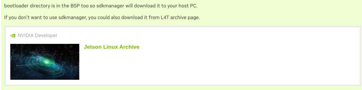

bootloader directory is in the BSP too so sdkmanager will download it to your host PC.
If you don’t want to use sdkmanager, you could also download it from L4T archive page.
