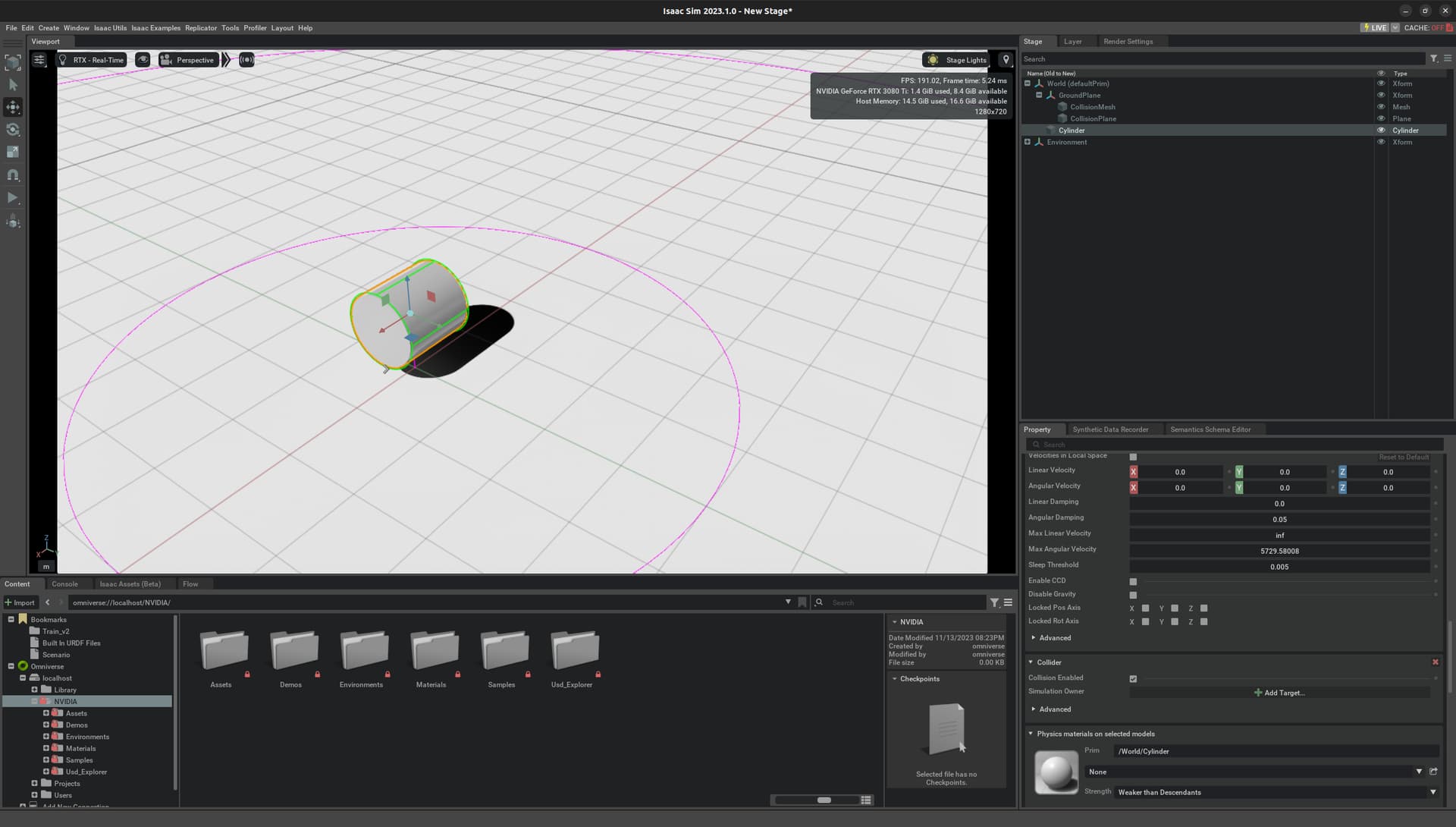

Hi, I am trying to set up a custom geometry for train wheel colliders and found some threads talking about Custom Geometry. However, there’s no such option in the collider tab with the type Cylinder. Is there any step I missed?
The ISAAC Sim version is 2023.1.0 and my environment is Ubuntu 22.04. Here’s the screenshot.
Thank you.
my understanding is when you do Add -> Physics -> Collider Preset on a shape (in this case, you do have a cylinder shape), it should create the custom geometry collider by default.
looks like you used Add -> Physics -> Rigid Body with Collider Preset, which should still be fine. are you experiencing unexpected simulation behaviors?
something tells me they may have removed that flag from earlier versions. but that’s something a mod/dev would be able to confirm.
Yes, the setting per prim was removed and replaced by USD stage setting. If you open Window->Simulation->Settings you can find it there:
The rationale is, if you want to have it per prim, you can control it by either creating a capsule shape or capsule mesh. But you should still be able to control the behavior per stage.
