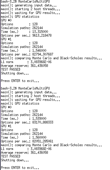

deviceQuery reports concurrent copy and execution and also compute level 1.3 as expected. I am a bit reluctant to report performance because I have noticed this card seems to have a throttle back mode where the clock speed drops and maybe even some cores are disabled. If you look at my screen shot you will see the MonteCarlomultiGPU code run twice. I have a PC 285 in there as well. There is factor of about 8 between full speed and throttle back on the mac card (check options per sec). I wake the GPU up by thrashing it with OpenGL benchmark between those two runs. Busy spamming other forums to see if there is a control panel somewhere to stop Green operation! On its own the Mac card managed over 100k options per second when woken up. I know this code much better than the histogram codes so am confident about these numbers.
 ![Picture_16.png](https://global.discourse-cdn.com/nvidia/original/3X/0/5/052c6463a090fb62ced1144ecaae20d1f171b12c.png)

Thanks a lot. Impressive, with my GT8800 I get about 40k ops/sec. So the GTX is really about twice as fast as the 8800 (as it should be).
If you have the time to post that histogram benchmarks sometime I’m still interested - especially because the histogram 256 is so hard to optimize, so I’m wondering if the GTX really has so much an advantage there. On the GT8800 I get:
histogram64GPU() time (average) : 9.565000 msec [//10454.783522](https://10454.783522) MB/sec
histogram256\_SM11() time : 19.650032 msec // 4853.296495 MB/sec
About the “Grren” operation of the GTX 285: I guess this only happens when you run the card not driving a display - right?
Suprisingly, no! The Mac 285 is the one I boot from and is attached to my main display - it is the PC card that is just cuda coprocessor and not driving a monitor most of the time, and that one stays up at 1.48GHz come what may.
With only the Mac card loaded I got it up to just over 100,000 options per sec - there is clearly an overhead for the multi operation.
So with the GTX 285 “woken up” by some initial bashing with 3D stuff, the corresponding numbers are
histogram64GPU() time (average) : 4.556000 msec [//21949.077018](https://21949.077018) MB/sec
histogram256\_SM11() time : 12.808063 msec // 7445.890527 MB/sec
If you do it with the card in Green mode, running at 0.6Ghz and who knows how many cores up, instead you get
histogram64GPU() time (average) : 16.646999 msec [//6007.088596](https://6007.088596) MB/sec
histogram256\_SM11() time : 24.688562 msec // 3862.818342 MB/sec
I hope this helps - it clearly illustrates the need to control the power management - the card itself is great IMHO.

In Green mode it reports
Options per sec.: 10054.988578
so that is 1/10 as fast. I do hope someone from Nvidia is reading this…
