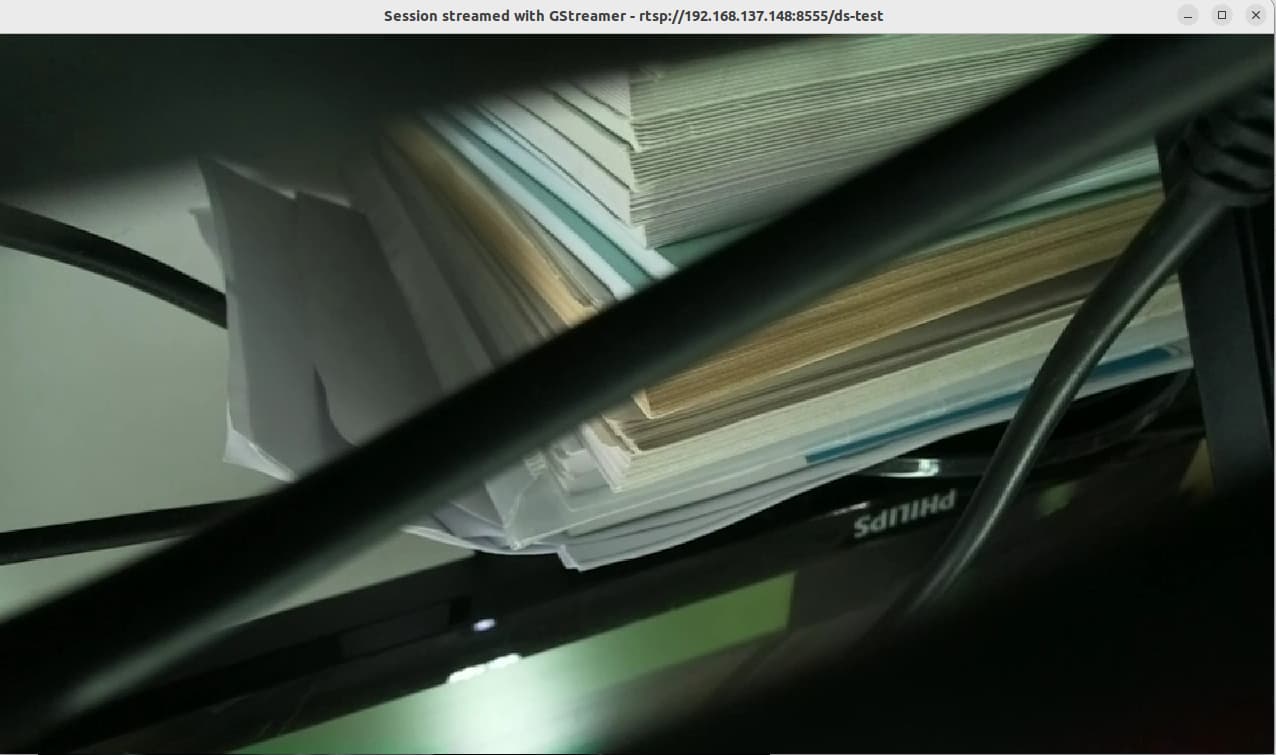

Why cant i add rtsp address of deepstream to VST
  • Hardware:Jetson Orin Nano 8GB
  • JetPack Version:6.2 [L4T 36.4.3]
  • AI NVR Version:2.0.1
  • VST Version:1.3.0-24.07.1
  • DeepStream Version:7.1
I just followed the quick start guid,and when i try edit the ds-config_nano.yaml or compose_nano.yaml,the deepstream container display restarting(0)

Move to JPS forum.
Can you share the log of vst container when you meet the error during add RTSP stream?
Thanks for your reply, when I added the RTSP address, the log content showed:[2025-7-28T7:41:38.223Z:281468911021024:sensor_management_utils.cpp:801: addSensor] Invalid RTSP URL
In fact, when I start my deepstream using ‘sudo docker compose -f compose_nano.yaml up -d --force-recreate’, it doesn’t start at all.You can check out the config files and pictures I posted above.
Can you have a try with nvstreamer: NVStreamer — Jetson Platform Services documentation. nvstreamer will generate RTSP from video file.
Yes,I tried NVStreamer, which can generate RTSP streams and display them in VST, but my problem is that I want to use Deepstream for AI detection, but as soon as I change the configuration file, I can’t start the entire container or add Deepstream’s RTSP address.
After NVStreamer generate RTSP, you add the RTSP into VST on VST webUI. Then DeepStream will start to inference on the new stream. You needn’t change the config of DeepStream.
But I can’t see the real-time inference results. I need to see the Deepstream inference results on VST, so I want to add Deepstream’s RTSP output.
You can add DeepStream’s RTSP output to VST. The RTSP name need include the word “overlay”.
What is the RTSP address of DeepStream? If it is port 8555, do I need to change the configuration file? I can’t start the container after changing the configuration file.
The RTSP address will be print in the DeepStream container log. You can config the RTSP port in DeepStream config file.
But the problem is that I can’t start the whole container anymore after setting the port.
Can you share your changes? You need to use SW video encoder as Orin Nano hasn’t HW video encoder.

Thank you. Above are the files I modified. I’ve installed the x264 software encoder using AI tools, following other posts. I’ve also modified the configuration files and gotten it working. However, I’m finding that the DeepStream output in VST is very poor. How can I fix this? Below is a screenshot of the result.
Seems there is h264 stream packet loss. Can you check if the RTSP stream quality with other tools(ffmpeg or VLC)? Can you have a try with below command line in: Quick Start Guide — Jetson Platform Services documentation
sudo sysctl -w net.core.rmem_default=2129920
sudo sysctl -w net.core.rmem_max=10000000
