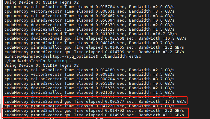

Why it is so slow to use cudamemcpy(cudaMemcpyHostToHost)on tx2
My needs are very simple.
I got 32MB data calculated by gpu, now I want to transfer the data to host and store the data to heap memory(int* data = malloc()) or stack memory(vector data.resize())
I decide to use pinned memory, show my code and test on my tx2

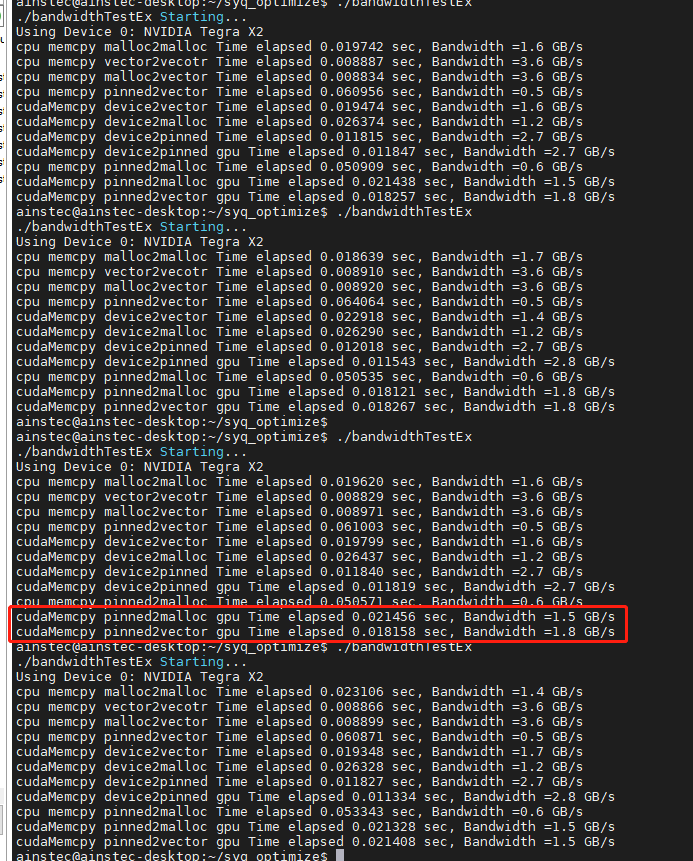

you can see , pinned2malloc or pinned2vector bandwidth is only 1.5GB/s, it become my bottleneck, Who can give me some suggestion or method to make the transfer more fast ? Thanks anyway.
In case you don’t know.
Have you maximized the TX2 performance first?
$ sudo nvpmodel -m 0
$ sudo jetson_clocks
Thanks a million, I follow your advice, it works!
I still have a doubt , Is 2.2GB/s have reached the limitation of tx2?
We don’t have a software bandwidth value for TX2.
But you can run the below sample on performance mode to see if you already reach the limit.
/usr/local/cuda-10.2/samples/1_Utilities/bandwidthTest
