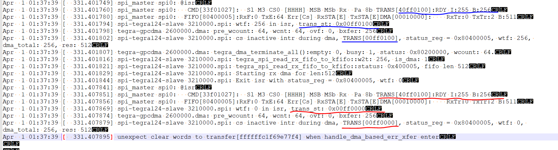

Configure SPI0 as slave in DMA mode. The external master would send variable length frames continuously. The SPI trans status blcok count value would been cleared unexpectedly in the isr, lead to frame dropped accidentally. Check below log, the blue mark log is normal state during an isr. The red mark log shows the block count value exsit when dump the register, but unexpetedly cleared when read-out later.
Could you please help to check why this happened? Thanks!
Further debug found, the block count value been cleared even before the RDY status been cleared. Please check below log.
Apr 1 01:37:38 [ 330.346170] spi_master spi0: @isr
Apr 1 01:37:38 [ 330.346178] spi_master spi0: CMD[33f01027]: Sl M3 CS0 [HHHH] MSB MSb Rx Pa 8b TRANS[40ff0100]:RDY I:255 B:256
Apr 1 01:37:38 [ 330.346182] spi_master spi0: FIFO[80400005]:RxF:0 TxE:64 Err[Cs] RxSTA[E] TxSTA[E]DMA[00010000]: RxTr:0 TxTr:2 B:511
Apr 1 01:37:38 [ 330.346189] spi-tegra124-slave 3210000.spi: tegra_spi_clear_status::trans status before write 0x40ff0100, after write: 0x00ff0100
Apr 1 01:37:38 [ 330.346199] spi-tegra124-slave 3210000.spi: tegra_spi_isr::wtf: 256 in isr, trans_st: 0x00ff0100
Apr 1 01:37:38 [ 330.346202] tegra-gpcdma 2600000.dma: pre_wcount: 64, wcnt: 64, ovf: 0, bxfer: 256
Apr 1 01:37:38 [ 330.346206] spi-tegra124-slave 3210000.spi: cs inactive intr during dma, TRANS[00ff0100], status_reg = 0x80400005, wtf: 256, dma_total: 256, res: 512
Apr 1 01:37:38 [ 330.346211] tegra-gpcdma 2600000.dma: tegra_dma_terminate_all():empty: 0, busy: 1, status: 0x80200000, wcount: 64.
Apr 1 01:37:38 [ 330.346219] spi-tegra124-slave 3210000.spi: tegra_spi_read_rx_fifo_to_kfifo::w2t: 256, is_dma: 1
Apr 1 01:37:38 [ 330.346231] spi-tegra124-slave 3210000.spi: tegra_spi_read_rx_fifo_to_kfifo::status: 0x400005, fifo len 527

Apr 1 01:37:38 [ 330.352598] spi_master spi0: @isr
Apr 1 01:37:38 [ 330.352610] spi_master spi0: CMD[33f01027]: Sl M3 CS0 [HHHH] MSB MSb Rx Pa 8b TRANS[40ff0100]:RDY I:255 B:256
Apr 1 01:37:38 [ 330.352615] spi_master spi0: FIFO[80400005]:RxF:0 TxE:64 Err[Cs] RxSTA[E] TxSTA[E]DMA[00010000]: RxTr:0 TxTr:2 B:511
Apr 1 01:37:38 [ 330.352622] spi-tegra124-slave 3210000.spi: tegra_spi_clear_status::trans status before write 0x40ff0000, after write: 0x00ff0000
Apr 1 01:37:38 [ 330.352633] spi-tegra124-slave 3210000.spi: tegra_spi_isr::wtf: 0 in isr, trans_st: 0x00ff0000
Apr 1 01:37:38 [ 330.352637] tegra-gpcdma 2600000.dma: pre_wcount: 64, wcnt: 64, ovf: 0, bxfer: 256
Apr 1 01:37:38 [ 330.352641] spi-tegra124-slave 3210000.spi: cs inactive intr during dma, TRANS[00ff0000], status_reg = 0x80400005, wtf: 0, dma_total: 256, res: 512
Apr 1 01:37:38 [ 330.352658] unexpect clear words to transfer[ffffffc1e2e247f4] when handle_dma_based_err_xfer enter
@nvidia-orin Is there anyone could help to check and give some advices? Thanks!
