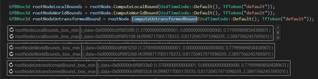

I would like to translate a prim to it´s center, to make sure that the translations that are applied are based on the center (for example the center for a rotation on the y-axis should be the center of the object).
So I wrote a method, that gets the bounding box from the prim (based on alle of it´s children) and translates itself by the half of the bounding box size.
UsdGeomXform, has three different methods to calculate the bounds…
ComputeLocalBound
ComputeWorldBound
ComputeUntransformedBound
,when I tried those three methods, all three methods produces exact the same result (ragardles of the transformations on the parents)…
Is that correct, or do I something wrong?
What´s even more wired to me I the fact, that when I try to transform those bounding boxes… nothing happens… regardless of the matrix a put in the Transform-method… the values do not change…

I was able to answer my question my self :-)
I have to call “ComputeAlignedBox”, to get the expected result. 👍
