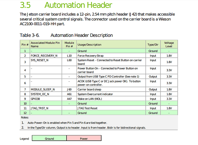

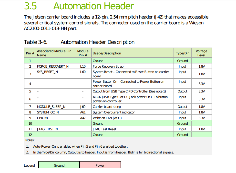

I’m testing wol on AGX Orin devkit with image flashed by SDKm
I’ve short the pin 9 and 10 of automation header
And try to enable the wol (sudo ethtool -s eth0 wol g)
Then the status show (sudo ethtool eth0)
Wake-on : g
Link dectected : no
The wol function is ok ,but I found the ethernet can’t connect anymore except I disable wol
Is there any step I was wrong?

I short the pins to test because our EE taught me to do that, I’m not sure it is correct or not.
No need to short this part. At least we didn’t do that on devkit…
