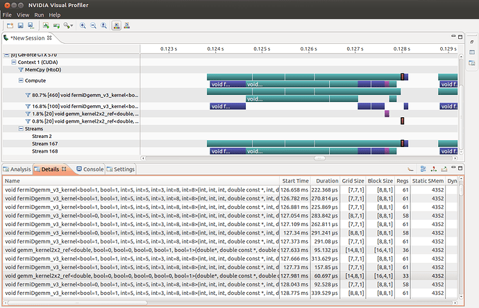

In short: i have a function (including cudaDeviceSynchronize) and its performance is affected by whether i reset the device before the function is called or not. instead of reset stopping the cpu thread for 2 sec with usleep() also works.
Are there internal hidden operations in the cuBLAS/GPU even after cudaDeviceSynchronize() ???
Note: I am not sure whether it is cuBLAS related or not and I use SDK 5.0.
In detail:
I have 2 streams, working parallel on dgemm operations. According to the broadcasted seminar i issue the operations in the correct order: “for each stream only one operation” . Check the attached profile, kernel overlapping is reached.

What’s happening?
