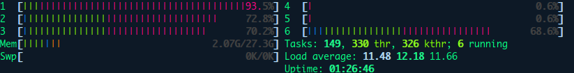

I haven’t been able to schedule any tasks on Xavier A CPU cores 4 and 5 (numbering 1-6). No matter the usage of other CPU cores , those cores stay idle. Screenshot of htop attached. Xavier B appears to be using all 6 cores just fine.
When I use taskset on Xavier A, the default CPU masks exclude CPU cores 4 and 5 (taskset numbers them 3-4). I can’t even schedule tasks on cores 4 or 5 – if I try, taskset returns an error.
I’ve done a lot of searching around the forums but haven’t found anything specific to my issue. No calls to isolcpus anywhere that I can find, nothing that would explain this.
My application requires full performance from both Xavier SOCs. Does anyone have insight into this problem? Thanks.

Could you check Only 4 cores out of 6 are available on Pegasus to see if it helps
Thanks for your suggestion, I missed this thread. I bet this is the problem.

The fix proposed in that thread worked.
