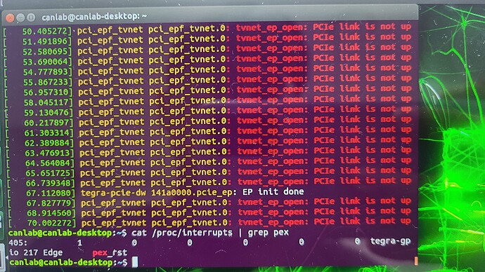

we have two RP system.
So we checked lspci and PERST signal in RP system. it works fine
But Another RP system lspci not works and diff PERST signal.
133
And we Checked /proc/interrupts pex_rst.
pex_rst has a non-zero count
Then Ep mode need specific toggle signal?

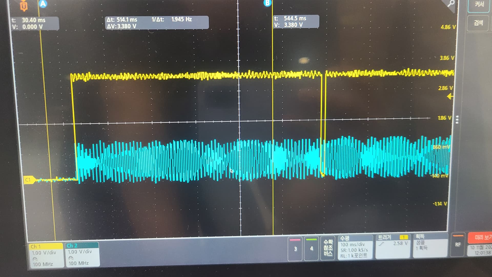

Xavier EP does not need specific toggle signal than spec. Do you mean the RP with PERST drop works well with EP Xavier and another RP does not with no drop? Why is there such different behavior?
@Trumany

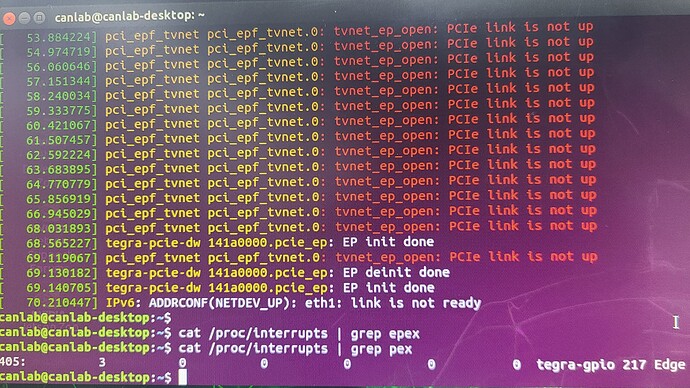

1: RP (Industrial PC) drop signal dmesg
2: RP (Desktop PC) not drop signal dmesg
I don’t know if it’s different for each PC
We use jetpack 4.4.1 Where should I check?
Are you using jetpack4 or jetpack5 here?
please try with some new jp4 image like jp4.6 or jp4.6.1.
JETPACK 4.4.1
1: RP system
2: RP system
some diff signal between two pc. Is this the right sign?

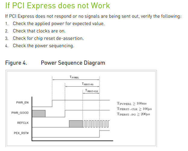

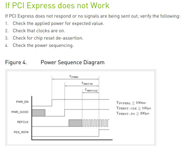

I found sequence diagram
according to diagram. 2 Rp system is right. isn’t it?
