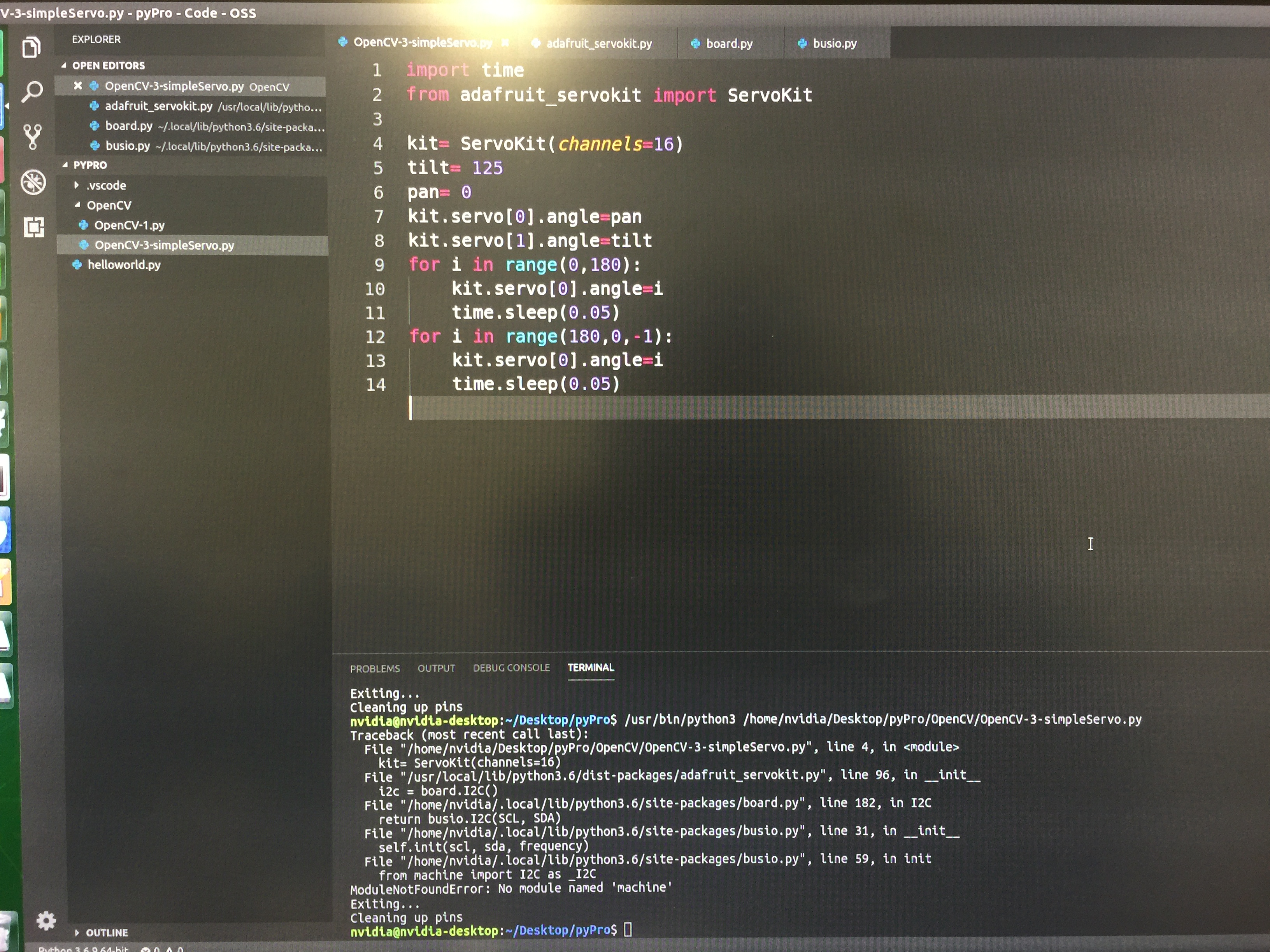

Do you use the adafruit library?
I follow this video but there is an error.
kit=ServoKit(channel=16)
This line creates an error "ModuleNotfoundError: No module named ‘machine’, but this error is from python3.6…busio.py
I assume the adafruit library has problem? Just wonder which library do you use.
I got the exact same issue, any progress on that? the "ModuleNotfoundError: No module named ‘machine’ I just can’t find a solution to this
So to answer my own question, /usr/local/lib/python3.6/dist-packages/busio.py needs to be modified, the error is in line 59 when it tries to import the machine module, despite my best efforts, and uninstalling, reinstalling, cleaning, and making 100% sure that said module was in fact installed, I just can’t import it to any python version, I get the ModuleNotfoundError
So all you have to do is change line 59 from:
from machine import I2C as _I2C
to
from adafruit_blinka.microcontroller.generic_linux.i2c import I2C as _I2C
I need to be very clear, I have absolutely no idea of what I’m doing, but after making this one change, now it’s working.
