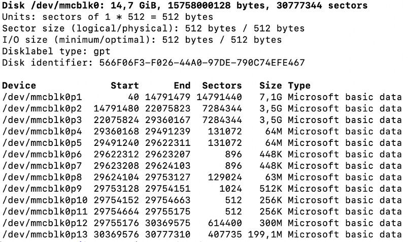

Exactly. We directly flash the Jetson with the three partitions as separate images using sudo ./flash.sh -r jetson-xavier-nx-devkit-emmc mmcblk0p1 and the SSD separately using dd. The p1 with root fs is split up into three partitions p1-p3 like this:
username@hostname:~$ df -h
Filesystem      Size  Used Avail Use% Mounted on
/dev/mmcblk0p1  6,9G  5,7G  853M  88% /
none            3,5G     0  3,5G   0% /dev
tmpfs           3,8G  4,0K  3,8G   1% /dev/shm
tmpfs           3,8G   38M  3,8G   1% /run
tmpfs           5,0M  4,0K  5,0M   1% /run/lock
tmpfs           3,8G     0  3,8G   0% /sys/fs/cgroup
/dev/mmcblk0p2  3,4G  1,3G  2,0G  40% /home
/dev/mmcblk0p3  3,4G  121M  3,1G   4% /home/username/log
tmpfs           778M   12K  778M   1% /run/user/120
tmpfs           778M     0  778M   0% /run/user/1000

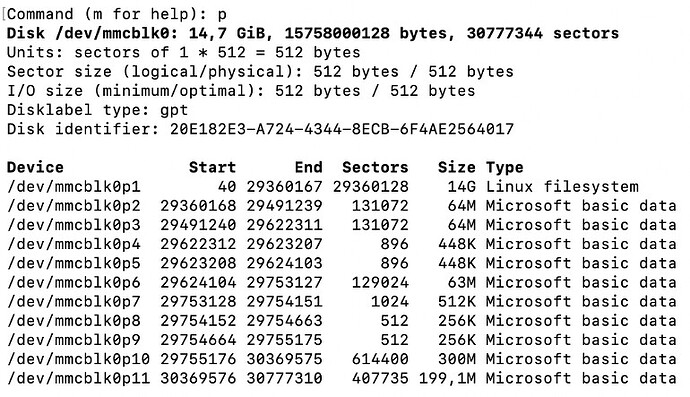

As just the p1 doesn’t have enough storage available for the OTA, we recover it like this:
a. sudo fdisk /dev/mmcblk0
b. d to delete
c. 3 for partition 3
d. Repeat last two steps for partition 2 & 1
e. p to verify deletion of p1-3
f. n to create new partition
g. Enter to confirm default 1
h. 40 for first sector
i. Enter to confirm last sector of 29360167
j. y to remove signature
k. t to change partition type
l. 11 for Microsoft basic data
n. x to enter expert mode
o. f to fix partition order
p. r to return to main menu
q. p to verify new partition order (p1-p11)
r. w to write and save changes
s. sudo resize2fs /dev/mmcblk0p1 to resize file system of p1

We found the issue with the OTA. It was due to the missing APP name of partition p1.
It is possible to change the name with fdisk using the commands from above but also including:
n to change partition name
1 for partition 1
APP for name
→ “Partition name changed from ‘’ to APP.”
